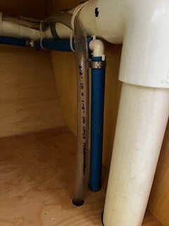

Hello, I'm new to all this. We recently bought a 2019 T@B 320S, (no Nautilus) and in getting to know its systems, I've found a dirt clog in the gravity fill air vent pipe, about 8" below where the pipe joins the gravity fill spout. I know it's dirt because a pipe cleaner inserted at the top came out dirty and gritty. I don't want to push the clog down into the water tank. The pipe is really inaccessible from the inside near the fill spout. Also, the tie-wrap they used to attach the vent pipe to the fill pipe is too tight, so the clog is kind of stuck there. I could probably manage to cut the tie wrap, but that's about all I could do from that point without breaking my arm.
I'm thinking of (1) cutting the pipe under the sink where I can access it, and then either blowing the clog out with compressed air or pushing it up and out with a very long pipe cleaner, and then (2) splicing with a plastic barbed connector.
Am I missing anything here? Am I going to screw our new trailer forever?
1st photo shows clog, gravity fill spout is to the right. 2nd photo is under the sink where I'd cut and splice the clear pipe.
Thanks for any advice you can give me! Louise C.

PS Your dirt clog may be a dirt dauber nest based upon the location. Water should dissolve the dirt but I would then drain the tank directly and not try to operate the water pump. Just a thought.

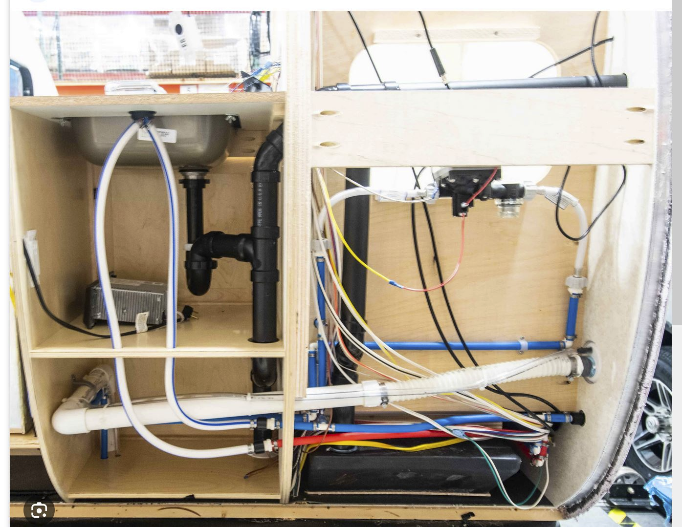

Not sure how you got the photo, but…good for you. This is, sadly, one of the most difficult areas of the trailer to access. There have been issues in the past with the city water connections failing, and owners sacrificing scrapes and bruises to get into that space. Owners who had it happen twice simply cut open access panels behind the toilet (after removing the toilet) to make this a much easier process. Look over the thread below, which has pictures and descriptions of exactly what is behind the wall. Once you can get back there, you should be able to replace that hose that connects to the PVC pipe that runs under the sink.
Access Panel For City Water Plumbing Leak
This is what that whole area looks like behind the front wall.

Thanks! I used my phone to take the photos, otherwise it would have been impossible to see what was going on in the clear pipe.
Yes, it was a dauber or some other insect. We cut the clear air-vent pipe in the bottom cupboard under the sink and covered the end that goes into the water tank with a piece of tape to keep it clean. Then after removing the too-tight tie wraps we used a long piece of 14 gauge insulated wire to poke from the little hole in the gravity fill thingy completely through till we could pull it out under the sink. That helped. We also rigged up a 1/4" barbed drip fitting to a 1/4" hose to a 1/4" compression-to-hose adapter which gave us a way to push higher pressure water into the little hole. It worked well, and with the other end of the hose in a bucket under the sink we pushed water through a bunch of times until the buggy pupae or whatever they were finally washed out, and the dirt. After it was all clear, we re-connected the pipe with a 3/8" plastic barbed connector.
And thanks for this photo of the back end of the Tab. I'm going to add it to my file.
Sounds like a great solution overall. I’m sure this will help someone in the future!
@LouiseC now that you explained your solution, I finally saw where the actual issue was. What a great way to sort things out!
The picture was borrowed from several threads that involve owners who took factory tours and took photos and videos that showed us "what is behind the walls". They have been really handy over the years. That photo came from this thread back in 2018 or so.
Thanks for the link to the factory tour. These pictures are super super helpful!
