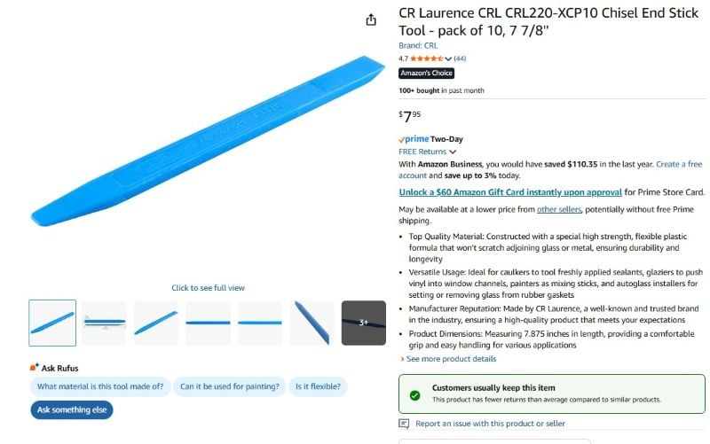

A quick comment about removing old, exterior caulk.
I found that Goo Gone Spray Gel Adhesive Remover really works well to remove the old caulk. I rub it into the joint with an old cloth to prevent dripping. After a few minutes the old caulk softens quite a bit. Then I use the plastic 'chisels' shown below to scrape the gooey mess off. The plastic doesn't scratch the finish and it can be easily sharpened with a fine grit sandpaper. Lastly, I clean the joint well with rubbing alcohol before applying new caulk. I hope this helps!
