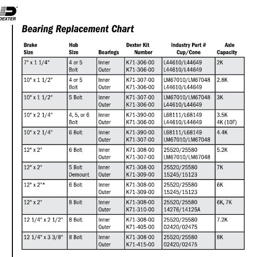

As a plan B I started shopping around for new hubs. The hubs used on our 2021 400 are rated for 4,000lbs and are extremely hard to find and are expensive ($150-300 per hub). Most 10” hubs are rated for 3,500lbs and are cheap and readily available.
In looking at Dexter’s manual it appears both 3.5k and 4k hubs use the same bearings (part numbers are identical)…which begs the question, wouldn’t 3.5k hubs works just fine in lieu of 4k hubs? To me the bearings would need to be beefier to support the extra load, right? I know this isn’t the safest conclusion to come to and I plan on emailing Dexter. It just seems that maybe they have a separate part number for 4k hubs in order to avoid confusion when dealing with a 4k axle?
Anyway, just curious if anybody here has managed to safely use 3,500lb hubs on their 400. It sure would make buying new hubs more attractive if I can’t find a shop to turn my existing hubs.

  • qhumberdqhumberd Administrator, Moderator Posts: 743
    I have the 2019 400 and have noted the chart seeming to show identical cup and cone part # for the 3.5 or the 4 K axle.

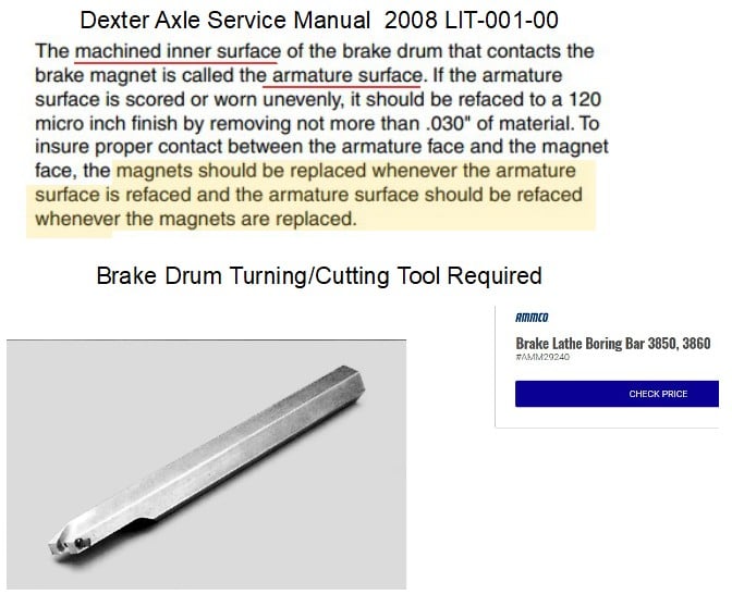

  • MuttonChopsMuttonChops Member Posts: 1,903
    The inner Drum Surface is called the Armature.
    A special Drum Turning Lathe Tool is required . . . < $200 for a shop to purchase.
    One of your more local, full service shops might be willing to invest in the tool if they have a reasonable trailer electric brake service operation.  Another option would be local machine shops that support industry/agriculture.  I once had a recreational boat rubber shaft repaired in a big machine shop . . . they gave the project to one of their super old techs that mostly did new guy training.
    youtube video on Armature resurfacing

    @qhumberd The doc you referenced is the same one I found. You’d think the hubs can support the same weight if the bearings used are identical…that’s where all of the weight is being supported…but I’m no engineer. I need to call Dexter.
    @MuttonChops Thanks for the info. Now I know what to call it when asking shops if they can machine it.
    manyman297 said:
    . . . thinking a grinding wheel on an angle grinder would suffice?
    While I understand the temptation, and might even try that myself, do question how wise it is as you have zero control on how planar the final surface would be . . . while a lathe operation will insure a planar surface. A non-planar issue top-2-bottom or side-2-side could be more of an issue.
    Which is why I'd just try new magnets . . . letting them form to the drum grooves. . . .

    @tabiphile I hear you completely but hubs for these axles is $150-300 EACH. These aren't run-of-the-mill 3500lb axle parts that are dirt cheap hence the crux of this thread. If I can use 3500lb hubs on this I'll just buy new hubs. If I can't then $300 in new hubs plus the $250 I just spent on new assemblies starts to sting.
    I'm putting in a call to Dexter today to see if I maybe they give dedicated part numbers to 4k axle parts just to avoid confusion and maybe they're identical to 3500lb parts.

  • manyman297manyman297 Member Posts: 1,432
    Just spoke with Dexter. Lady I spoke with wasn’t sure so she spoke to another tech and he confirmed that 3500lb and 4000lb hubs are interchangeable. You just can’t use a 3500lb assembly (backing plate, shoes, etc) on a 4000lb axle. So I should be fine buying new 3500lb drums.
