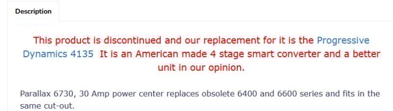

Various 6730D replacement searches recommend the PD-4135 as a replacement.
Those searches suggest the 4135 is the same outside dimensions as the 6730D.
From one Convertor Supply Company:

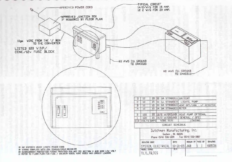

I'm not aware of a yr-2012 typical wiring diagram. Does your 6730D have any 120V Breaker labels or 12VDC Fuse labels to assign a technician with the installation? The 6730D appears to be a simple unit with very few breaker & fuse positions.
Attached file has a typical Dutchman 2008 electrical wiring diagram . . . since the 6730D has limited breaker/fuse positions it is possible your nuCamp build is similar.
