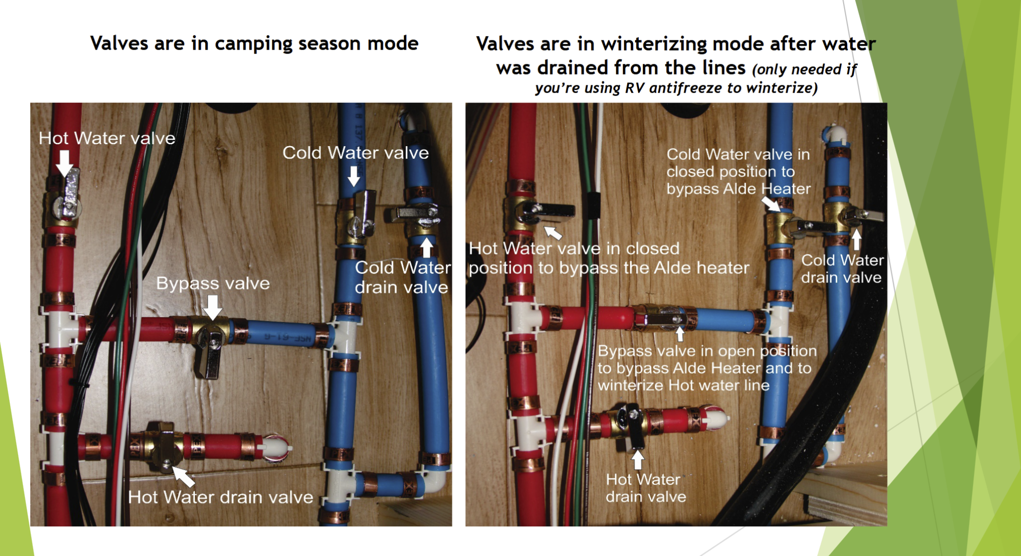

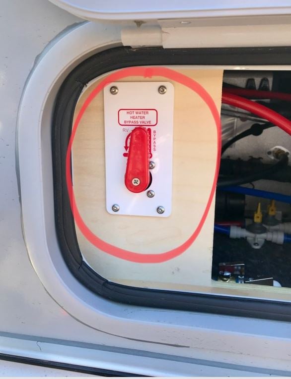

And, if you do sanitize….and you should, remember to put the Alde valves in the "Winterizing" position.
Forgot that! Thanks! I think on that older T@b it would be labeled Bypass?
Rich2019 T@b 400
For the pre Nautilus owners
@Horigan a 2016 still has the "traditional" Alde valves. Pictured below is the basic "pattern" of the valves for the "Winterizing/Sanitizing". The picture above of the "Big Red Bypass" handle is from "about" 2018 in a 400. Some of the first Nautilus 320's (2021 2.5 Nautilus) had the "Big Red Bypass Handle, also. Here is a screen shot of the two different configurations.
@jolamanna you can find these "charts" in the Winterizing Manuals over in the Manuals section
