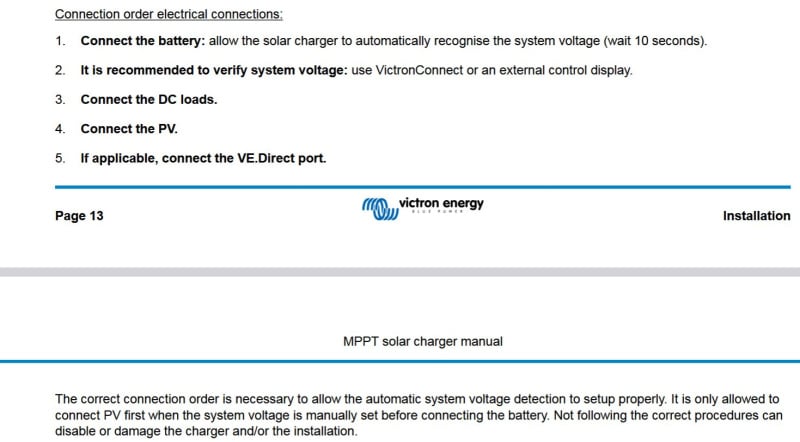

    The proper way to connect the Victron solar controller is by: connecting the solar controller to the battery first...then letting the controller read the battery status...and then connecting the solar panels. If your trailer was outside, the solar panels were still providing power to the solar controller.  The controller, in order to get things straight, needs to sort out the battery state of charge before the solar panels start providing power/
    Find the solar controller in the trailer.  Pull the fuse from the solar panel wiring there at the solar controller.
    Find the fuse/fuses for the battery at the battery disconnect switch area (they may be near the Gloso circuit breaker, or disconnect the battery cables again.
    Then: open the Victron app and connect the battery cables, and see if the Victron now senses the battery status and sends the info via bluetooth.
    Then reconnect the solar panel fuse at the solar controller.
    What exact battery do you have?  It is really hard to "freeze" a battery, especially inside the trailer.
    This is the paragraph from the Victron MPPT manual that describes the proper order. (Ignore #3, about "connecting the DC loads".)
