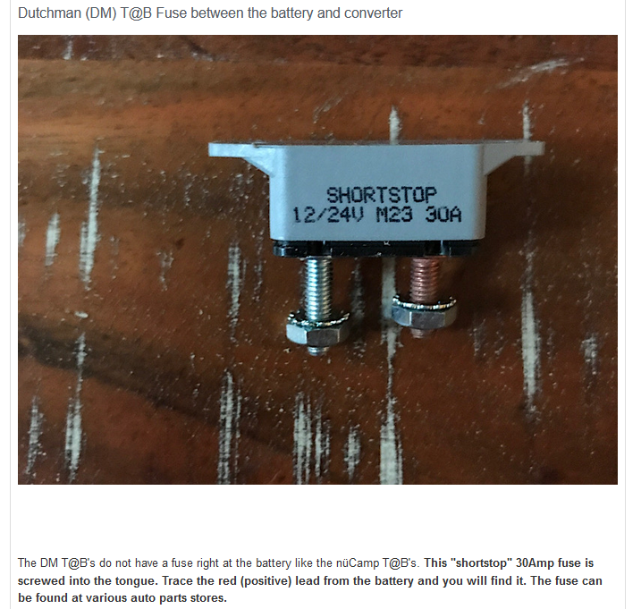

As @Grumpy_G noted on the Dutchman TAB that fuse location (battery) should be 20A so don't increase beyond 25A . . . but I expect it will still fail/blow.
Consider:
1) taking battery to an auto-supply-store and have it tested.
2) disconnect the battery Positive wire(s), connect shore power, does fuse blow?
most Dutchman TAB have a Short-Stop Device that could have internally shorted to ground
Reference one (short-stop not included in this diagram):
Reference two, Short Stop Device:
