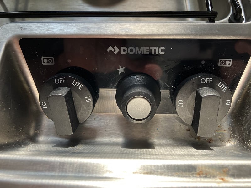

Interesting. I didn't realize there was a battery on the igniter. Can we access this without removing the cook top?0
Yes the push button unscrews, and then you pull the AAA battery out.2021 T@B 400 BDL aka Little Joe

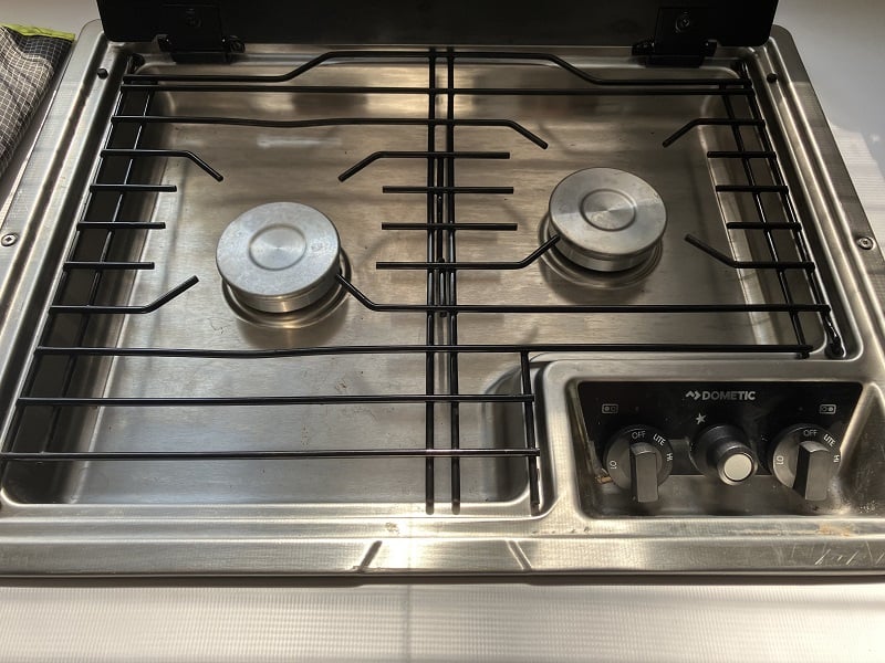

Here's the stovetop in place. Simple two burner with igniter.
The igniter button simply unscrews to change the AAA battery.

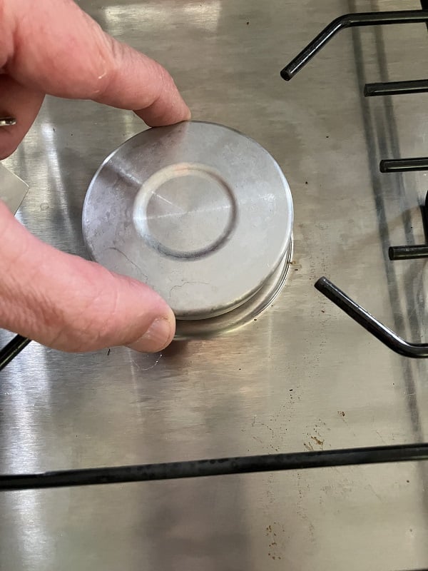

Here's the burner plate that had vibrated loose and was banging around under the grates. (The other burner plate was also loose, but only 1 screw had fallen out, so it was still attached).
