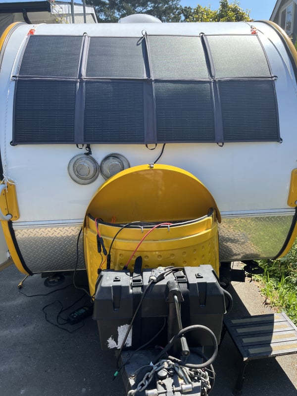

I used galvanized wire to attach mine.Also: if not already covered see if you can cover the fridge exhaust vents. I got Mason bee (similar to mud dauber) nests in mine, which plugged up my fridge. I spent $1000 to have the fridge pulled and all the cement like mud removed. They are bigger vents, so I used stainless steel wire colanders, attached with galvanized wire.2014 T@B 320 S "Sunny" - 2015 Toyota Sienna LE - British Columbia, Canada0
Great idea. Ouch on the $1000 for the repair. I'm getting obsessed with covering up the various trailer vents to deter wasps.1
Here’s a view of the colanders below my new solar blanket
they aren’t much of a fashion statement but they work great. Also, they were $6 at Walmart.
2014 T@B 320 S "Sunny" - 2015 Toyota Sienna LE - British Columbia, Canada0 -
