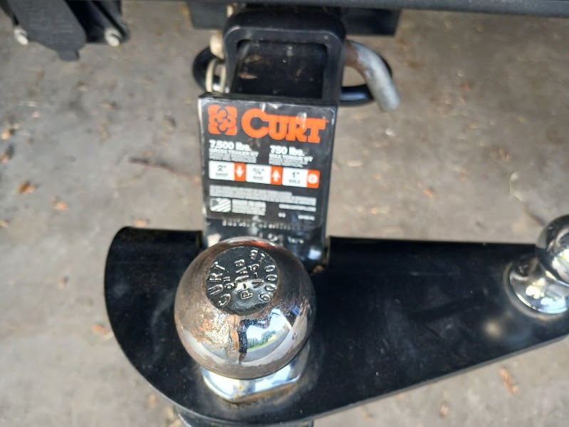

Has anyone had to use an adjustable tow hitch to lower the hitch ball on their Honda Ridgeline to connect to the 2022 Tab 320 Boondock? I am very new at this and will have my first tow lesson tomorrow! The Tab is sitting on my gravel side drive and I have not tried to hook it up yet but will try today! I've asked AI Grok for assistance, and here is what GROK has said "The 2019 Honda Ridgeline Sport AWD receiver hitch height is ~19–20 inches (top of receiver, unloaded), dropping to ~17–19 inches with sag. The Curt V-5 S0700U-R2’s 2-inch drop should be marginally sufficient for the 18-inch coupler height of the 2022 nuCamp TAB 320 S Boondock, but a 3–4 inch drop may provide a more precise level tow. Ensure the hitch ball is 2 inches (matching the trailer’s coupler) and test the setup for levelness" I am sure someone else has asked this question so I appreciate everyone's wisdom and guidance! I am attaching a pic of the hitch that came with the sale of my Tab 320 Boondock. Thank you in advance for all of your help!
Everything is just fine with my setup to tow my beautiful 2022 Tab 320 Boondock! I am a newbie who is simply overwhelmed!!!!!1
have resolved your "tow bar" rise/drop question and have a nearly level if not level (ideally) small Ridgeline sag.

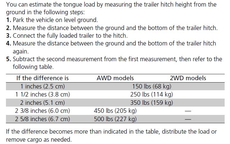

The 2017 Ridgeline User manual notes what sag to expect by tongue weight . . . {what does your manual say}
