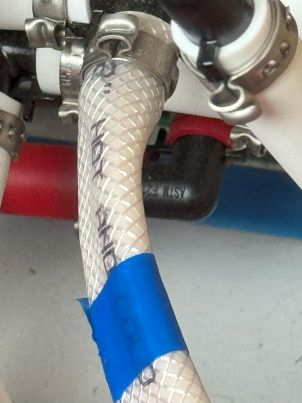

I verified my valve setting at the site and looked in the Alde compartment. I noted the cold-water supply line to the pump was collapsed.

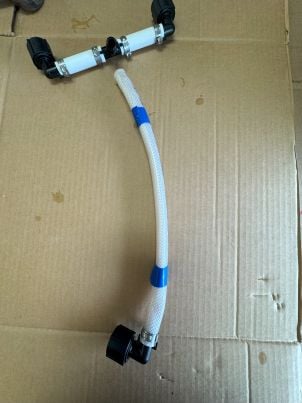

Reading through No Hot Water type discussions on the forum I learned of potential suction problems with cold supply check valve being installed backwards, etc. So, I assumed my collapsed line was the problem and waited until returning home to remedy things. At the house I had trouble breaking the crimp connectors on the PEX in the confined area, so I removed the assembly at the nearest screw on fittings, at the Nautilus and water pump.
With the crimp connectors and vinyl tube removed I made a new supply harness using PEX instead of the vinyl tubing. I had to trial fit several times and after it all 'dry fit' well enough I put most of the assembly together in the garage. I had to make one final connection in the T@B. All total I used two 90degree fittings and about 2feet of 1/2" PEX.

I'm pretty sure when I had the collapsed line it was because I'd forgotten to change the Nautilus to 'dry camping' prior to turning on the pump. Between using pliers and my fingers I was able to reform the hose to the round shape again without issue.Debbie in Oregon

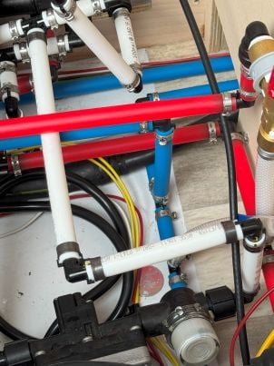

This was very helpful. I replaced the hose with pex like in this diagram. While I am not new to campers, I am new to the Tab 400. This is a simple and rather ignorant question (I know) but I have water running out of the drain lines that are up under the camper. Both of these lines have a toggle switch on the floor where all the hot water heater and piping is. The water seems to run with the toggle in either position. Am I missing something simple here. Please say yes.2023 T@b 400 boondock0
Welcome to the Forums, and welcome to the Famous Yellow Flapper Valve club.What year is your 400?The Yellow Valves are: drain valves for the two hot water tanks. (You may only have one, depending on the year). One of the Yellow Valves also works as a "pressure relief valve" for the plumbing. If you are on city water, and did not use a water pressure regulator on the hose.....the Yellow Valve opens and releases the pressure, and water is dropped out of the drain.When the valve points up, it is open. When it is "horizontal", it closes. But: it can be pushed "below horizontal" and cause the valve to let water escape. I'm sure you have played with the valves a bit, and you can just sort of feel when it pops into place by itself. Check to see if you have pressed it down too hard.It is also possible for these valves to fail: they are spring loaded devices and eventually the spring will fade a bit.You also should check for exactly where the water is coming from under the trailer. The Yellow Valve drains are directly below each valve, you can look underneath the trailer and see them.There are also low point drains for hot and cold water that need to be checked. (The year of the trailer is important for this, too.)

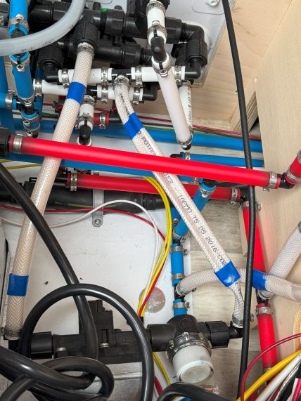

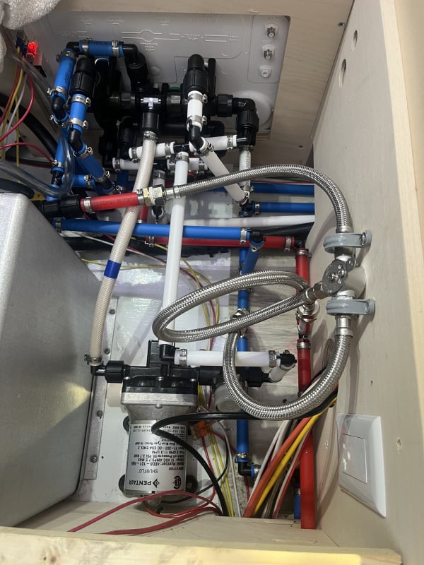

Ok folks. I finally have hot water flowing. Thanks again for all the help. I have replaced the flexible hose that was deflated with pex. I still had no not water. I removed the mixer and it was clogged. put it back on and had hot water for about 30 seconds. It clogged up again. obviously the tank needed to be flushed. I replaced the mixer with one that does not have a screen on it and is much easier to adjust than the alde one that came with the camper. A replacement alde mixer was about $170. The one I bought on amazon (which I prefer since its easier to adjust and has no screen to get clogged up again) was $27.69. HYDRO Master mechanical water mixing valve. Since it had 3/8'' screw on fittings I purchased metal flexible piping and then cut all the lines into and out of the mixer and replace with the flexible metal piping
putting new shark bite clamps on the new connections. Presto change, it all works, finally. Thanks again everybody for all the help.
