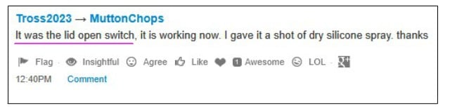

Problem Resolved
FYI. Tross2023 posted this on the Activity Wall
