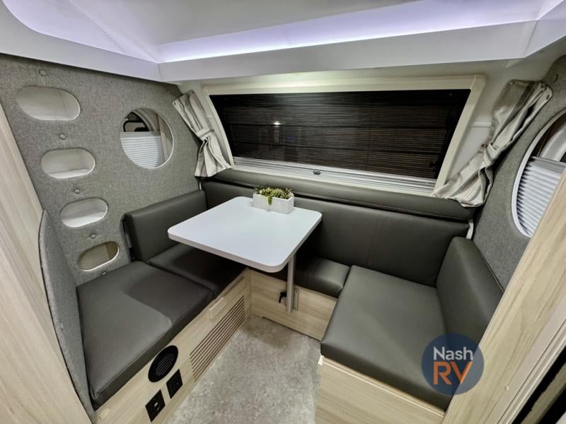

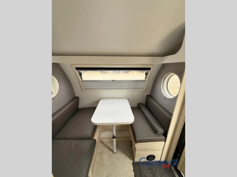

Hi all. I kinda figured out some of this through one or two posts that did part of what I'm trying to accomplish but hoping someone did the whole thing. Is it possible to remove the bunk bed from a Tab 400, install the larger table used in the non-bunk bed floor plan? Does the wall below the window have any holes in it once the bunk is removed or does it look just like a tab 400 that did not come with the bunk minus the curtain buttons (like the picture below)? Second, can the storage box be removed to regain the foot space? Not sure how it is attached to the sidewalls and if the finished panels continue past the leading edge of the box in your picture below. Basically want to transform a bunk 400 to a non-bunk 400 with the only noticeable difference being the button for curtains. Any advice/suggestions are appreciated. -Joe
