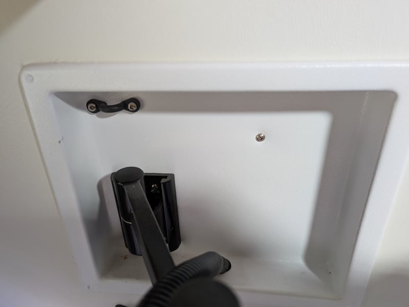

@RedDoorGals we have a 2022 T@b 320s BD. Here's a picture of our alcove box.
Outside measurements of the plastic alcove insert:
11.25" wide
9.5" tall
approximately 1.75" deep.
Inside measurements:
9 5/8" wide
7 15/16" tall
The wire opening is offset to the right a bit. The hole is 0.75" in diameter as best I can measure. There is
4 1/8" from the right edge of the hole to the alcove's right inside corner and 4 1/2" from the left edge of the hole to the left inside corner. The corners are kinda rounded so not easy to get an exact measurement.
BandB THANK YOU!! that's perfect and what we needed to know! It takes a village...!2018 T@B CS-S; pulled by a 2010 Toyota Tacoma v60

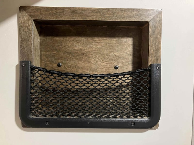

We have a 2021 320S Boondock. Here is a pic of the opening with the plastic frame removed and another with a small cubby that I built to keep misc stuff. Let me know what you do regarding a charger outlet. I've been thinking about putting one in. I think I could tap the 12v television power cord to wire the USB charger. The black electrical tape is holding the cords that used to run to the television.Dimensions of the raw opening are 10" x 8 1/4" x 1 5/8". The depth is to the face so you'd have to subtract the thickness of the wall to get the depth of the available opening to mount a charger. The whole cavity below is open. The right side has available space to run wires but the left side has a solid barrier.

WayneW; thanks for your comment and the photo. I'll leave you a photo when we've got ours installed. Yes, we're taping into the television 12V line to install a "cigarette lighter" type device; then we'll plug the male charging insert into that for 2 USB charging ports.
