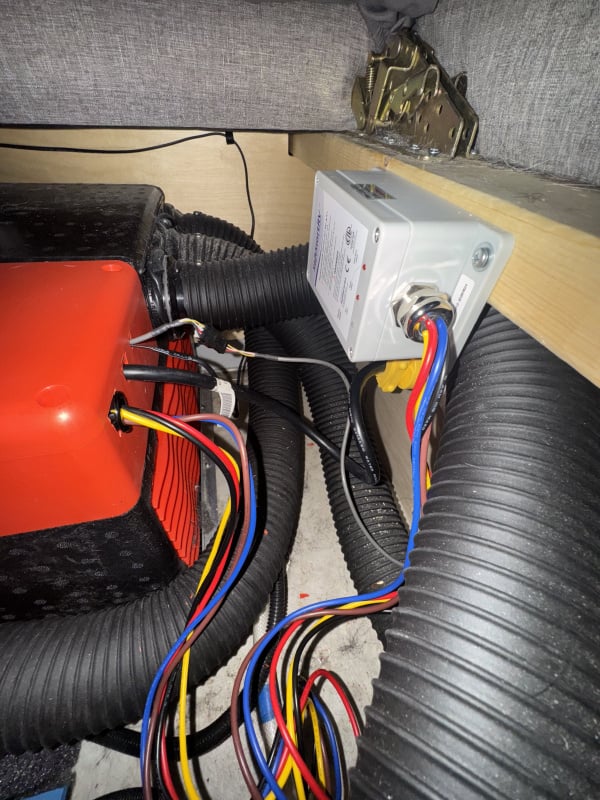

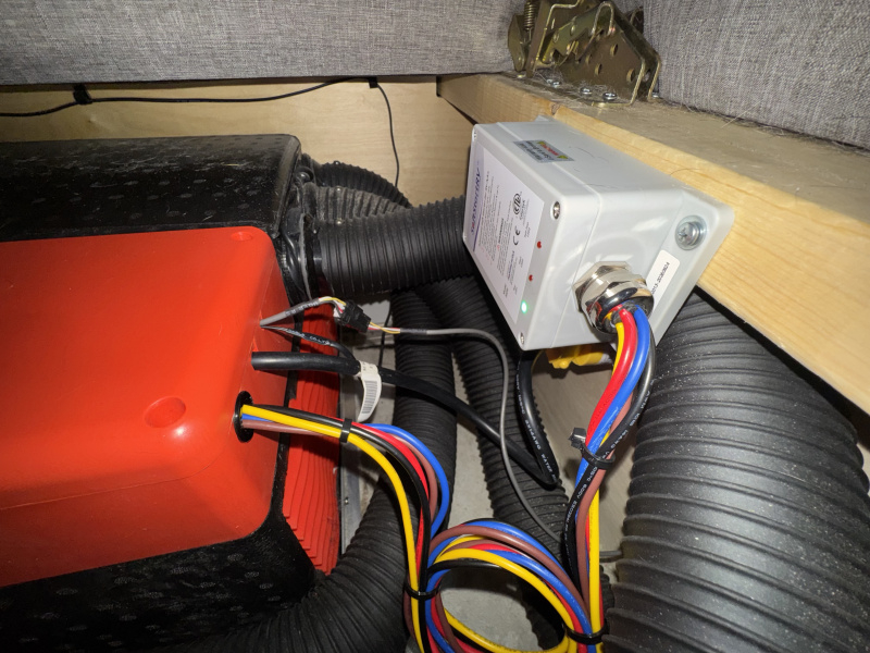

I received the SoftStartRV SSRV3T. I opened a ticket and got a call for an install walkthrough. It was simple and quick. Luckily I had wiring tools, including a wire cutter/stripper, a ratchet crimping tool, some male/female spade connectors, some shrink wrap, a heat gun, some grommets, and some Aleve for the contortionist moves in the tight space.
I tested in a BLM spot. Started my Champion 2500 gas generator, made sure it is NOT in Eco mode. Started the Air8, no compressor “thump”! After a minute I set it to Eco mode and it ran fine for 10 hours, with thermostat set to 68°.
So this Winter I may head to Quartzsite, AZ sooner than last year now that I can run the Air8 off my generator. I carry a 5 gallon fuel cal on the spare wheel of my JLUR so I can run the Air8 for 50 hours if I keep filling the generator tank. Last year I got there in early November, I think I will go in early October.
I used two long screws to securely attach it to the 2x4. It comes with 48" of cable so can mount it anywhere. I like it here so if I ever need to take a peek at the LEDs, I only have to lift a cushion a couple inches. Very happy.
