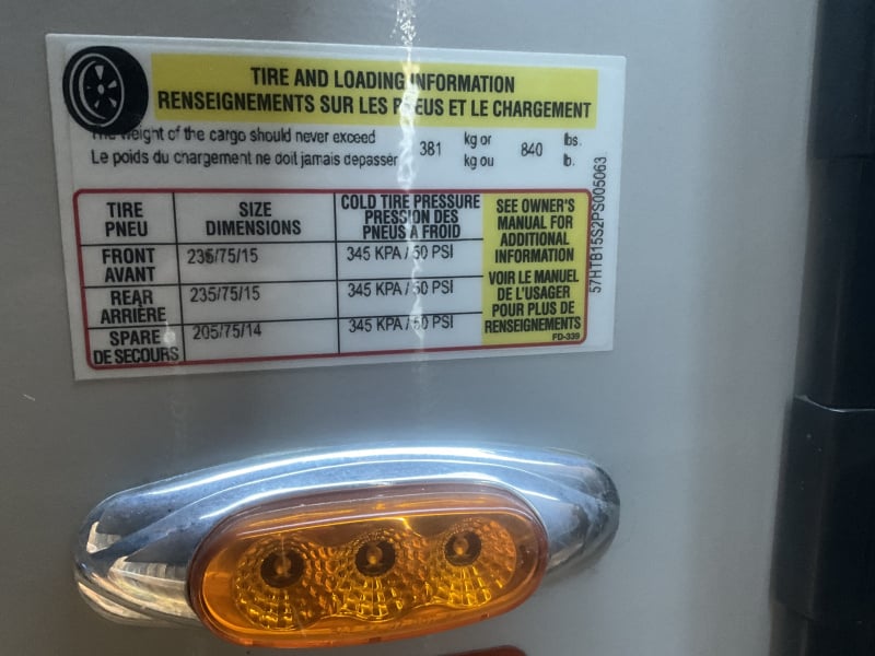

Here is a copy of my vin placard. The size of the tires on the placard do not match my tires, which were put on by the dealer. Purchased it new 10 months ago.
It's very frustrating that it's so hard to to figure everything out for this camper. Thank God for this forum though.
The placard only applies to the tires (or the tire size, at least) that came with the trailer.This Goodyear page explains how to interpret the tire pressure charts.

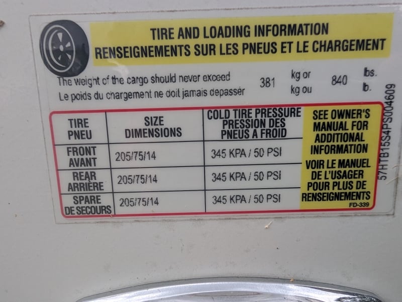

I'm the first buyer of this camper, these are the tires the dealer sold it with as a new never been used camper. However, my placard shows a different tire size. I am assuming it's because mine is a small run "signature series" that has some boondock components but not all. Another poster posted an example of the placard and his shows my size tires but I don't know if they are the same sidewall type of what tab he has.
Thanks for the link. I had read that and it brings me back getting the dealer's table on psi by weight. Unfortunately, I can't find a Goodyear psi table that shows my tires. That's why I made the original post, as I found other threads about how these tires were standard when my camper was built. Hoping to find someone who had these tires and found the psi/weight table. Or had these tires and could tell me what psi they use based on their model and then I'll just make a guess based on their weight.
I did find other stuff from Goodyear that said "consult your vin placard", which doesn't work for me since the tires don't match the placard.
