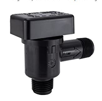

On your black tank flush there is a check valve behind the sink that could be a leak point but the only way to check it is to remove the folding sink.

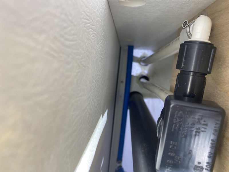

Here is how I took mine down with pictures from my 2019, which should be similar
https://tab-rv.vanillacommunity.com/discussion/15361/t-b-400-bathroom-folding-sink-removal-add-panels-and-shelf#latest
The valve pictures are here (white lines going behind panel going to check valve and then down to black tank):
Thank you for the information and the photos. This helps a lot!0
@AuntNess others have mentioned a small borescope to get a look without complete teardown of the area. If you can see a connection or that check valve leaking when you have eyes on, that would be an easy fix. As you can see from the pics the line goes from the outside of the trailer up to the check valve and then down to the black tank so your options for leaking are contained at least. I have no idea how to access the entry point to the black tank, but think that might not get water on the bath floor since it is below that leve.
Let us know what you learn.2019 T@B 400 Boondock Lite towed by 2016 5.7L Toyota Tundra
I had a similar issue, found out it was a (dead) stick bug that got into the valve that @qhumberd had detailed above and kept the valve from fully closing. I cleaned it out and put some screening around the valve.2022 T@B 400 Boondock
