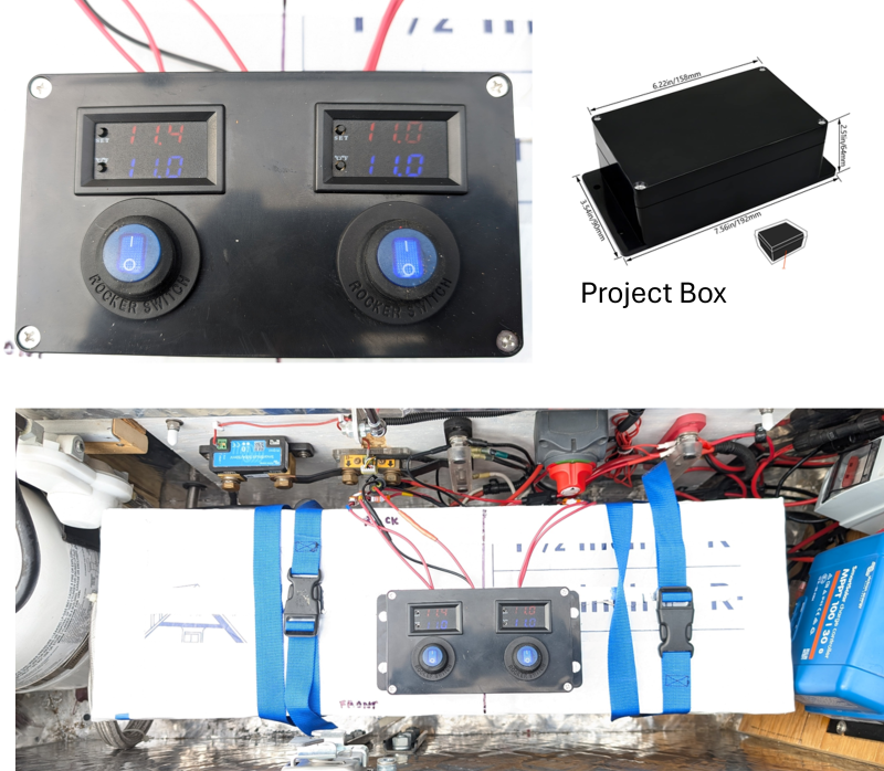

Lithium Battery Warming System
Downers Grove, IL
2017 T@B 320S Max, Blue and Silver -- "The Blueb@rry"
Did your 2017 T@B come with any lithium or solar or is this a fresh install?0
No solar or lithium when I bought it. I upgraded to lithium batteries and added a rooftop solar panel this past spring. The solar and lithium upgrade made boondocking easy during a long (35-day) expedition this past summer.

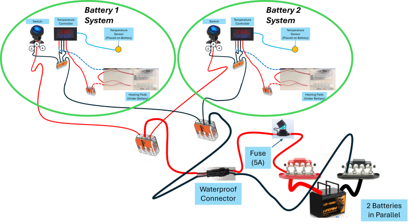

Do you have a components list and links to their source?2021 Tab 400 Boondock
2020 Audi SQ50 -
Item
Description
Source
Silicone Rubber Heating Pads
15cm x 5 cm; 12V; 20W; set of 4 pads
Project Box
Junction Box IP65 Waterproof Dustproof ABS Plastic Universal Electric Project Enclosure with Fixed Ear Black 6.2x3.5x2.5 inch (2pc)
20-Gauge Galvanized Tie Plates
Used as heat distribution for heating pads. Placed one on each side of the heating pads.
Toggle switches
Waterproof Round Rocker Switch with Shell 12V Blue LED Rocker Toggle Switch Lighted ON
Rigid Foam Board Insulation
Pro Select R-Matte Plus-3, 0.5 in. x 48 in. x 8 ft. R-3.2 ISO Rigid Foam Board Insulation
Temperature Controllers
wDC 12V Electronic Temperature Controller Programmable -50 to 110 Degree Celsius Heating/ Cooling Thermostat Control Switch
