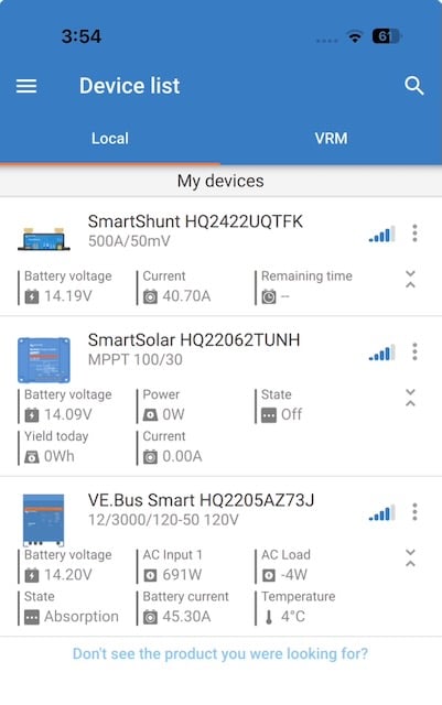

So I plugged the camper in and all the Victron components reported a battery capacity between 14.10-14.20v. Guess the battery was OK after all? Anyways, it'll be plugged in for the winter...
The "battery heaters" really do not need to be on. The only reason to heat the battery is: if you "need" to charge the battery when the "interior of the battery" is below freezing. If the inside of the battery is below freezing (inside the battery) you can damage the battery if you try to charge it. If that happens, the the battery "low temperature charging protection circuit" will kick in, and prevent battery charging in that case. When the temps warm up, the battery will begin charging again. If you are really needing to charge the battery and the battery is below freezing...by all means, use the battery heater.The voltage you are seeing is really only the voltage going into the battery. Have a closer look at the shunt "consumed amp hours" and see what that reads. You can also go into the Shunt history section and look at "deepest discharge" and "last discharge" and see if you can tell what the last/low discharge was.If your battery/camper completely shut down, you need to sort out why that happened.
If you look at the SmartShunt numbers, it shows that 40.70A of current is moving into your battery. VE.Bus (Multiplus? Not sure - I don't have the equipment) shows 45.30A of current. The VE.Bus also shows "absorption" not "float" which means the battery isn't fully charged yet (but getting close).johnVT said:So I've been in touch with Jordan at NuCamp. I asked if it was OK to leave the camper plugged into shore power (with the battery heater engaged) through the winter, and he confirmed that it was.

Either something is using a heck of a lot of power in your camper or the battery was severely depleted and the converter is working pretty hard to recharge it.If you're not using the camper over the winter and you're in a location (Vermont?) where the temperature is frequently below freezing, personally I would make sure that absolutely everything is shut off - zero power in/zero power out. If you have a way to keep it plugged into shore power your alternative would be to keep the Multiplus on but be sure to keep the battery heater on so your battery is protected when the charger kicks on when the ambient temperature is below freezing.San Francisco Bay Area | 2013 CS-S us@gi | 2015 Toyota Tacoma PreRunner Double Cab
