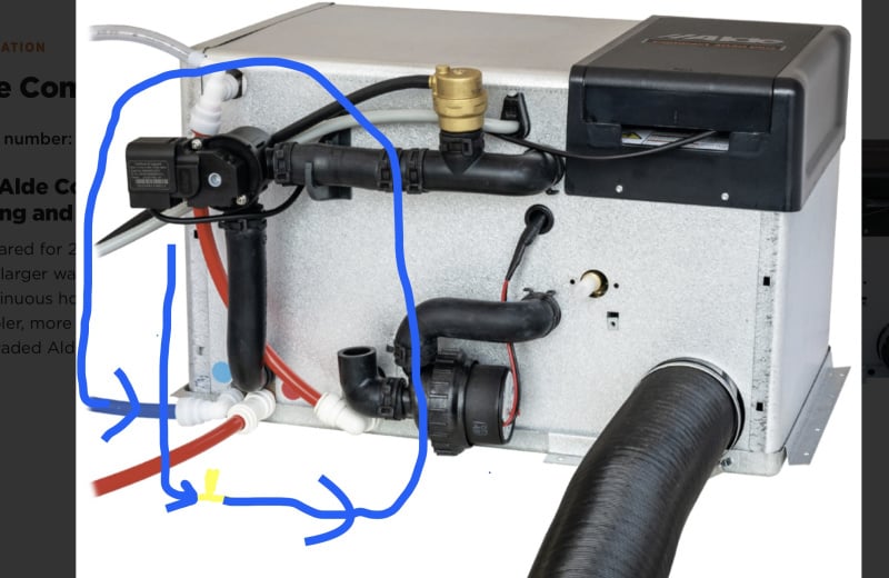

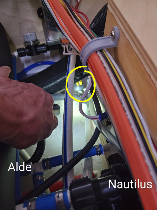

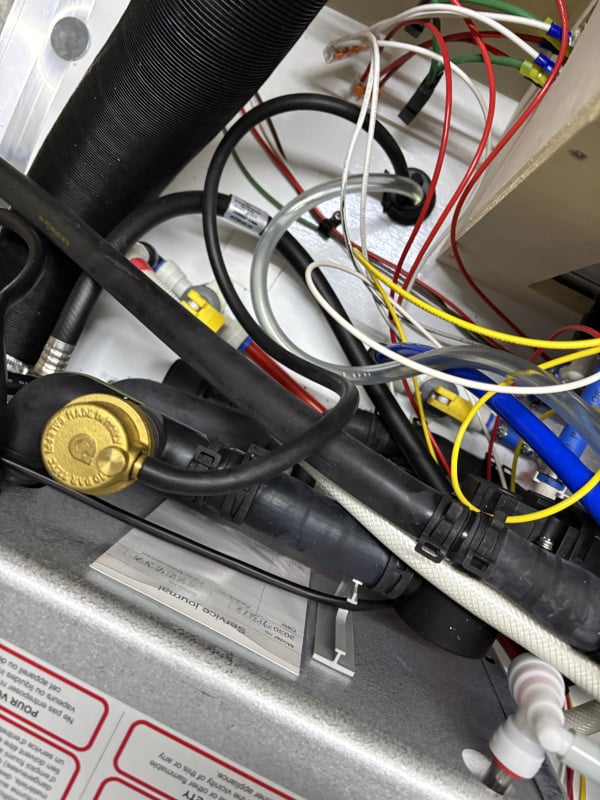

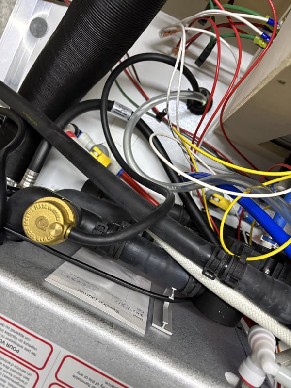

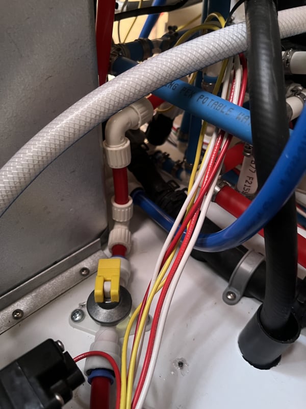

Found out this morning the Alde 3030 "Plus" in the new 400's (2025 and on) does not have an Alde Flow installed.  Consequently, there is only one Yellow Valve in the Alde 3030 trailers.
You can see the single yellow valve circled in the photo below, buried under the harness for the Nautilus.

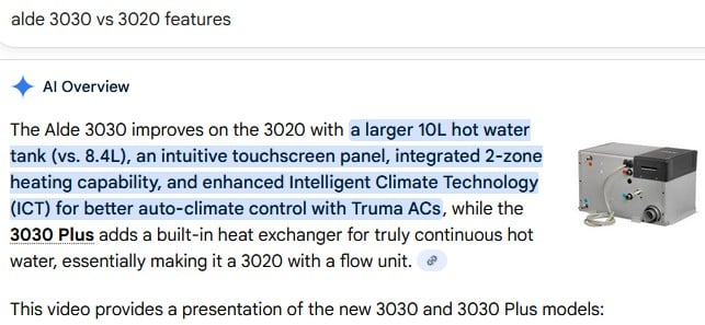

    3030 has slightly larger tank, Alde claims the 'flow' is built-in

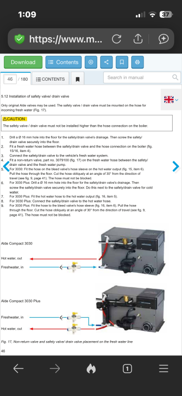

    We apparently have the 3030+. (No description of it from the dealer at delivery walk-through, and our NuCamp welcome bag contained an Alde manual for the 3020!)
    When I began the winterization process last month, I became quickly confused (something that comes pretty easily for me): there appeared to be no way to gravity drain the boiler tank, since the plumbing took the cold-water inlet piping from the one flapper valve up and over everything else down to the boiler inlet. I contacted NuCamp tech (included some pics), they replied, "It looks like you're right, I'm not seeing a 2nd valve there. In that case, your only option would be to blow out the lines with compressed air.” To confirm that the tank and inlet piping were effectively blown out, NuCamp suggested that I "disconnect the blue hose sharkbite from the Alde when you're done to see if anything else drains out. (probably put a towel down first).” I did as suggested, and no water drained out. Bit of a pain, but easy to do.
    I’ve read the 3030 manual, and my reading of it provides no enlightenment of a way to gravity drain the boiler tank. Our 400 was built July 2024 (delivered June 2025). Maybe plumbing in more recent builds has been modified to allow for gravity draining—or maybe a gravity drain isn’t particularly needed for winterization? Attached is a pic of our Alde 3030+.

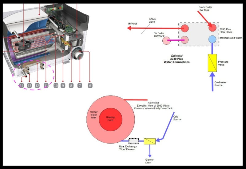

    The 3030 Plus Plumbing should be something like this:
    It would be Super Helpful if @f1xedgear could provide some simple diagrams of how his 3030 Plus unit is connected to the trailer fresh water plumbing so the above estimate can be refined.
    It would also be helpful to know how the Yellow Valve Input Side (the high loop) is connected to the trailer cold water and/or Nautilus panel.
    Side Note:  3030 Plus have a NEW Control Panel Interface.
                      And it is dumbed down . . . i.e. more useless/confusing for troubleshooting

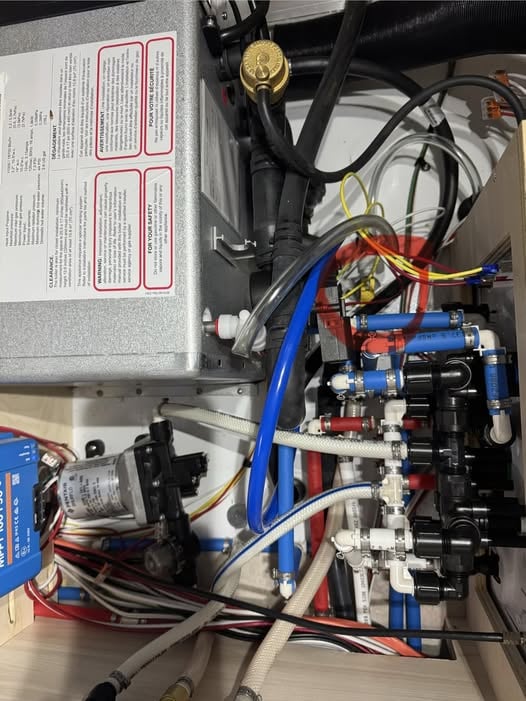

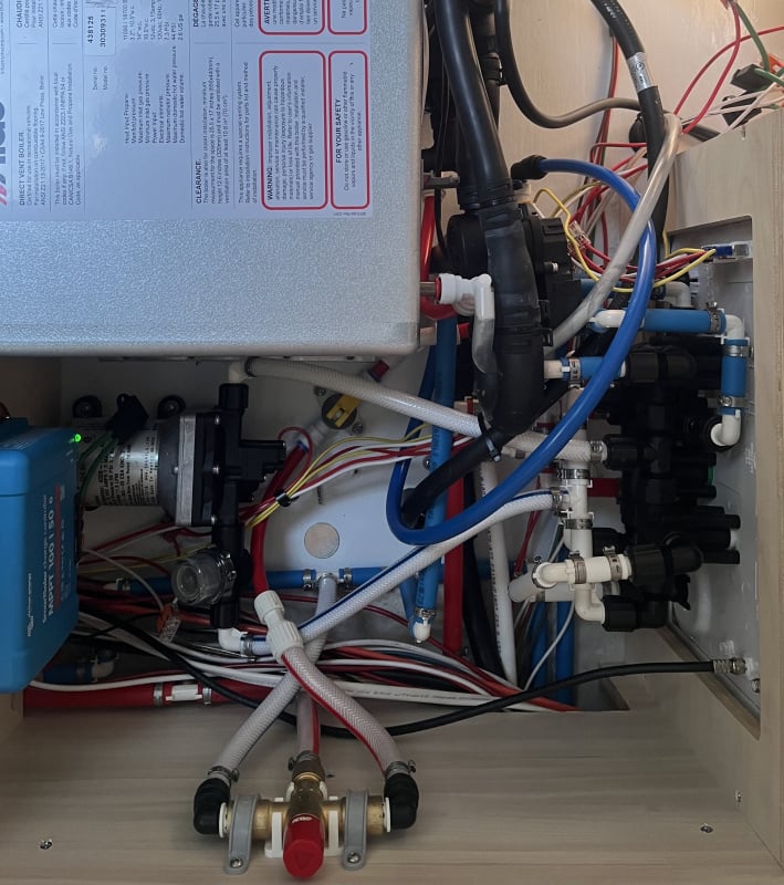

    pthomas asks: "What happened when you opened the Famous Yellow Flapper valve?"  Not a lot. That’s what made me take a closer look at the plumbing. . . . "does the yellow valve connect to the blue (cold water) line, and the blue pipe coming "up" in your picture is the supply line for the Alde hot water tank?” Yes.

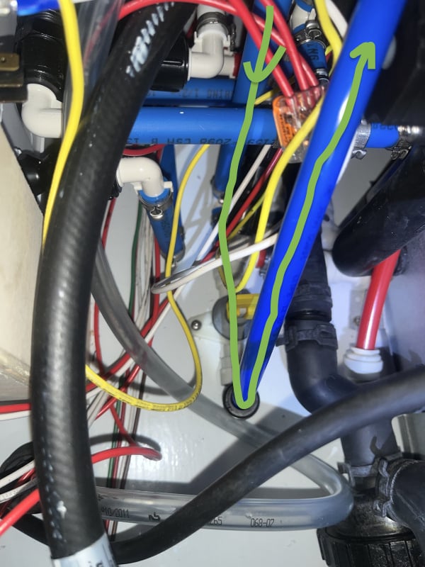

    I attach several more pictures that I hope better explain the plumbing we have. The blue line below is the cold-water inlet path to the boiler.
    The low-point here—the yellow bit—shows basic location of the valve. Obviously, to my mind, that location won’t work to drain the tank. Could it possibly serve as a pressure release for burping?

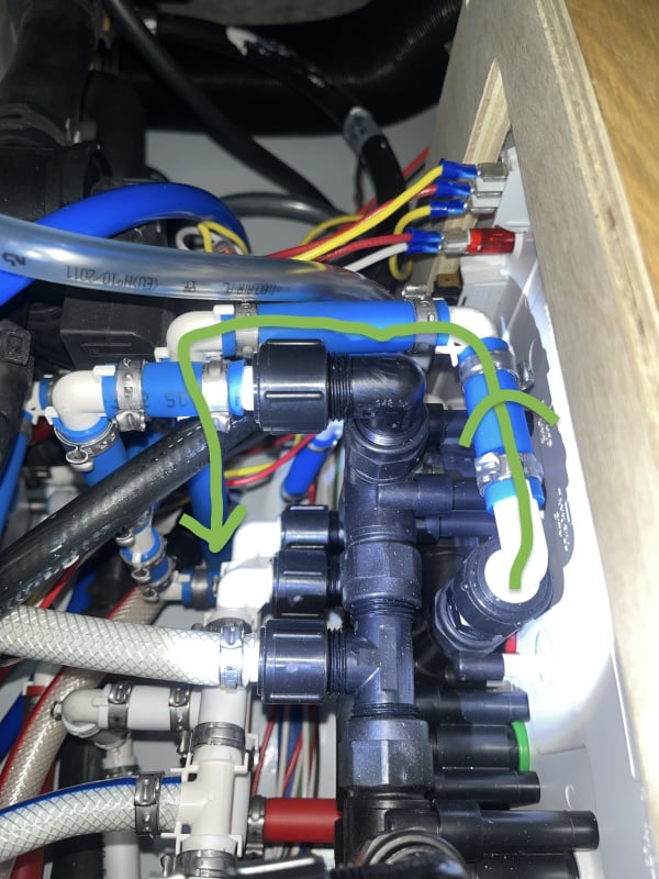

    Below is our 3030+: The green line is the cold-water inlet from the Nautilus.
    I assume that my blowing out the lines also forced out the water in the tank. The test for that (as suggested to me by NuCamp) was disconnecting the line at the 3030+ cold-water inlet and finding no water coming out. Yeah, it was disturbing and disappointing to find that as NuCamp's remedy for draining the boiler tank.

    @f1xedgear  interesting  ( thanks for figures )
    {{quick reaction to your recent post }}
    IMHO nüCamp did not install the 3030 correctly.
    Consider:
      a)  changing the Yellow Valve to 3030 hose routing to a flat elevation hose.
      b)  asking nüCamp do pay dealer to fix under warrantee
      c)  if (b) is rejected ask nüCamp Engineering Department to justify why the
           routing in your trailer is correct/acceptable.  No one should have to open/break
           plumbing fitting to complete winterization as recommended by nüCamp Support

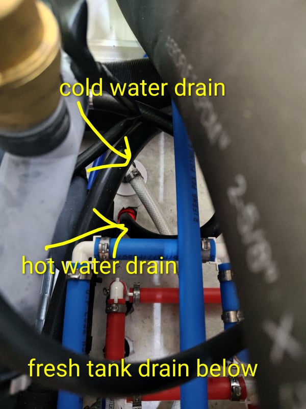

    I have 2025 tab 400 with Aldi 3030 plus with 2 yellow valves located on each side by boliler adjacent tire well. Very high physical effort to open two yellow flapper valves !
    MuttonChops Member Posts: 2,085
    Okpete said:
    . . . 2025 tab 400 with Aldi 3030 plus with 2 yellow valves located on each side by boiler.
    . . . high physical effort to open two yellow flapper valves !
    Any chance of you providing a few pictures (different angles/views) of your Adle setup, they would be helpful as everyone tries to learn how the 3030 is being installed.
    "physical effort" generally the Yellow Handle is very easy to flip up/open.  Are yours jammed by other tubing or just very difficult to reach . . .

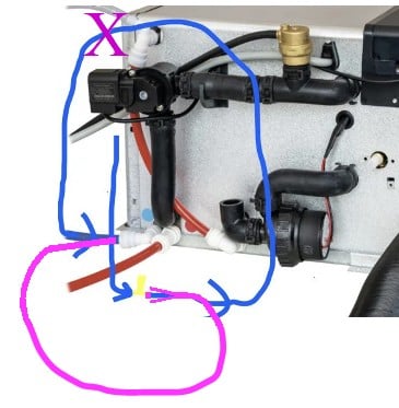

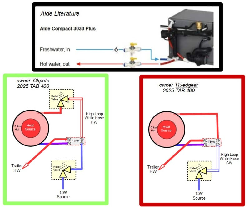

    This has gotten interesting.  Both @f1xedgear and @Okpete have 2025 TAB 400 builds with different Alde 3030 Plus Plumbing configurations.
    I'm hoping that @Okpete's rig has a newer production date as his Two Yellow Valve set-up:
       1)   Better matches the Adle literature for installation
       2)   Allows full Hot Water Adle Tank Area water draining with the two valves
    IMHO If @f1xedgear actually has a newer build date rig . . . then we really need nüCamp to explain how to fully winterize an Adle 3030 Plus when there is only one Yellow Valve and a possible high point water . . .won't drain issue.
    For Reference my estimation (based on pictures) of the two Plumbing configurations.

  • f1xedgear
    f1xedgear Member Posts: 9
    Our 400 is an earlier build: July 2024, and a June 2025 purchase. So, it seems nuCamp eventually fixed this incorrect install but then didn’t/hasn’t notified owners (or dealers) of the fix for early production units. Seems to me that some sort of service bulletin issued by nuCamp is warranted. Thanks, Okpete and Mutton Chops, I have a little more info to go to nuCamp with a warranty request to correct their install error.

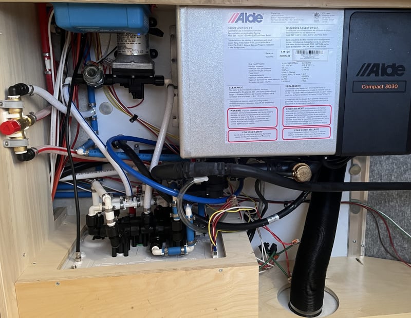

    Joining this thread a bit late but FWIW the setup on my 360 (Sept 2024 build) is a 3030, non Plus, with from what I can tell one yellow flapper. The owners manual says it's use is to replenish the air cushion every 10 days of use, accomplished by briefly exercising the valve. Makes no mention of draining. However, there are two lever action drain valves on the underside below the unit, one for cold water and one for hot water. Are these low point drains on all units? (There is another drain for the fresh water tank.). After winterizing with pink juice I open all low point drains, then blow out the system. I've never used the flapper during that process (and initially didn't think I had one because it's buried under an AC line). But so far so good;  l love the system it works really well for us.

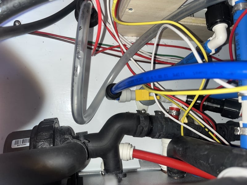

    My Alde 3030+ repair is finally done. I now have two flapper valves. Hurrah! The new 2nd valve is in place for the hot water line exiting the boiler. Not the same configuration as Okpete showed us for his system, but should work for the purposes of resetting the air cushion, I guess. Not so sure it's gonna properly gravity drain (the line goes up and over the cold water inlet), but I'll work through that later this fall. The dealer's tech did the repair with instructions from nuCamp, who apparently were baffled by the fact that this 3030+ had been installed wrong.
