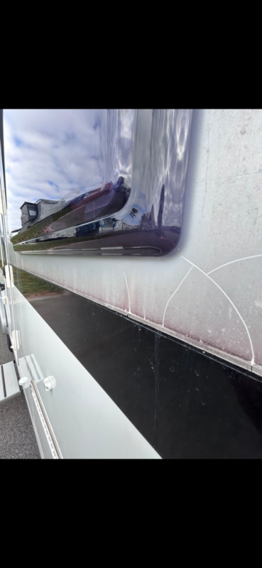

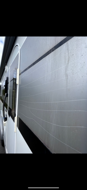

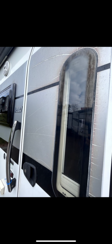

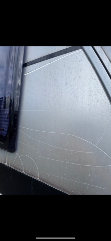

Hi, I’m look at an Avia near Atlanta and I’m seeing cracks on the exterior wall. Is this a major issue and what could possibly be wrong. Thank you Jay
  • Georgiabulldog
    Georgiabulldog Member Posts: 6
    edited December 2025
    Rv
  • Georgiabulldog
    They’re telling me it’s just an old sticker/ decal?? I’m going soon to see it. My first time posting. Sorry!
  • Georgiabulldog
  • Georgiabulldog
  • B0atguy
    B0atguy Member Posts: 269
    Appears to be just cracks in the vinyl decals from the hot Georgia sun !
    I would guess that NuCamp can furnish some new decals for you . They do them all in house . Prob will not be cheap , and removing the existing "cracked" decals will NOT be easy !
    Good luck , looks like a nice Avia except for the decals.

    I'm not sure I'm buying the idea this is a "sticker/decal".  Add this to the list of "things dealers say".
    Be very very careful here.
    The Tabs have basic composite sides which have a thin layer of fiberglass over it, called "Azdel".  The brochure below describes the sides of the Avia is Azdel covered with "Lamilux4000 Fiberglass Skin".  The skin apparently gives an aluminum type "shine" to the exterior.   The lines in your photo could be cracks in the "Lamilux" layer.  I can not find any photos of Avia's with any variations in the basic "decals".
    The brochure below describes is a "Lamilux4000" outer skin over Azdel in the "Exterior" section.
    This could just be cracked fiberglass, or, the cracks could have been caused by some sort of "bump" that caused the cracks.
    Here is a search that describes "Lamilux".
    This link describes the Lamilux warranty (which is only 2 years) but it does say on the last page that the material can "accept automotive paint", whatever that means.
    There are many former boat owners in this group who have discussed basic fiberglass repair, but I don't think there is much on this sort of "cracking".

    I am fairly certain that those are cracks in the decals , exactly like the dealer is stating . Its characteristic decal cracking on boats and RV's . The cracking is on the sidewall decals and the door decals on the same side . Fiberglass cracking is not going to radiate into separate door area . I highly doubt that what we are seeing here are fiberglass "stress" cracks or impact damage on this scale. The unique random cracking structure is a tell tale sign of decal cracking .
    I am in the boat business (40+ years) and see this all the time . Its fairly common . Predominantly in boats that are sitting for extended periods of time in the sun . Usually one side is worse than the other , due to the boat being stationary on the "hot" side for a long time . Decals get hot, they shrink and crack . Quite difficult to remove as well , since they get "baked" on . Happens a lot on RV's as well .
    Lamilux is just what they are calling the fiberglass/gelcoat exterior skin panel that is over the Azdel panel on the outside surface . Its just more higher end , refined , and visually appealing than the fiberglass/gelcoat exterior skin panel that they are using on the T@B models . If you look close on most T@Bs, you can visually see the "strands" of fiberglass showing through the gelcoat . Lamilux is just a better , more refined fiberglass product , that does not show the raw material under the gelcoat . A lot of higher end fiberglass RV's are using Lamilux . Wish they would have used Lamilux on T@B's . Not sure what they are using on the Haven ?
    No Rv models have just "Azdel" on the exterior . There is always a fiberglass skin with gelcoat overtop of the Azdel.  Azdel is a just "backer" that replaces the old style lauan that has been used in the past , and maybe is still used in inexpensive RV models (thats why older RV's had delamination problems).
    Also, NuCamp has not used Azdel since 2023 . This 2020 Avia would have used Azdel as a backer though .
    NuCamp now uses NTXT , an Azdel replacement . They manufacture there own sidewalls now , and they are claiming that their Azdel replacement , NTXT is as good as or better than Azdel . Time will tell to see if it holds up as well as Azdel .
    @Georgiabulldog , inspect the unit thoroughly before handing over any money . I am fairly certian that what you are seeing is not fiberglass damage , but decal damage .
    Let us know what you find when you inspect the Avia .  Other than the exterior decal damage , it looks like a very nice unit. If its decal damage , try to get them to knock off some $$$ . Then decide if you want to tackle that job.
    If it does turn out to be some kind of strange fiberglass damage (highly doubt it) , then do not proceed with the purchase . Thats a whole other level of repairs you do not want to get into .
    Good Luck !

    I think that it's really critical to figure out whether what's splitting is just the vinyl sticker/wrap, or whether it's the laminate layer. If it's the former, it should peel like a sticker. If it's the latter, I would think that it would be brittle and wouldn't peel. If they really want to sell the trailer, and it's really just a degraded sticker/wrap, see if you can get them to pull up a small area so you can see if it matches the Adzel exterior wall where there was never any sticker/wrap (the white areas). If you can see anything that looks like foam (maybe test it with a pin), I'd say that it's the exterior Adzel layer that's cracked. I would say that would be a deal breaker. Even if it's just the wrap/sticker, it's not repairable and it would probably be a PITA to remove. So it's up to you whether it's priced attractively enough that you can live with it.
    pthomas745 Administrator, Moderator Posts: 4,686
    @B0atguy thanks for responding, knew we  had fiberglass boat experts in the group!
    I based my "assumption" on "that doesn't look like a decal to me" but after looking at a lot of photos of the Avia, it certainly does seem to be a decal over the fiberglass "skin".  The photos in this thread didn't show me the design of the decal very clearly.  All of the other photos I found show the same basic design on the side of the Avia.
    I would think the place to examine would be the areas below the solid black line along the side of the trailer.  If the cracks are not below that line, then the decal is the obvious problem.

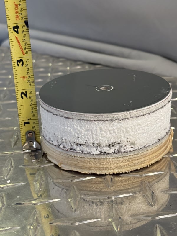

    Here is a picture of a side wall core from a 2024 400 . You can see each layer pretty clearly.
    Gelcoat color on the fiberglass "sheet" , exterior NTXT , foam block insulation , interior NTXT (with soft touch "wallpaper" ) , and interior plywood in this application (completed wall panel would not have this plywood part). The only thing you dont see here is the aluminum "cage" framework .
    This is from my personal 2024 400 , I had to drill a 4 1/2 " hole a few days ago .
