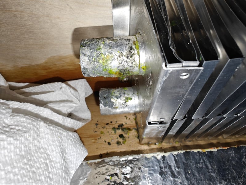

I have a 2016 Tab 320 with an Alde 3010 that has never had the fluid changed and it started having a small leak from one of the convectors. I noticed a tear in the hose but when I removed it I quickly discovered the aluminum was so corroded it ate holes through it. Turned out all of the connection points were that way.

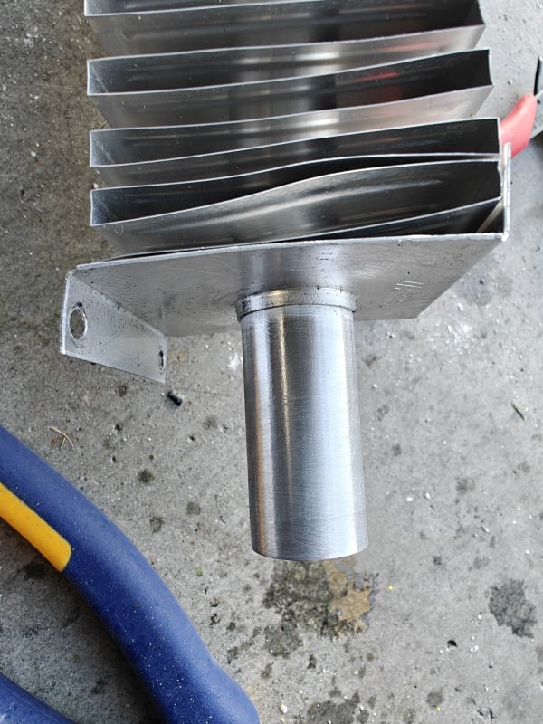

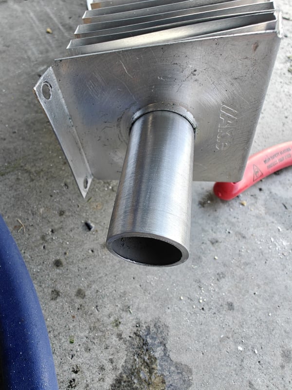

I found it to be hard to get replacement parts (even hoses with the odd diameter where hard to find) that would ship to the US. At least I couldn't find any, plus I'm cheap so I decided to cut the corroded ends off of every convector and was able to find some hose on amazon that was heat rated and the correct dimension. Between home depot and harbor freight I had everything I needed for cheap. The only thing I needed was transfer fluid and that stuff is expensive. I didn't know how much I would need for the flush and didn't want to spend $70 a gallon for what appears to be the same old style of green/yellow fluid that came out of it. After researching on Alde's website they state alternative fluid that meets their standard. One of those is VW Group G12 coolant. The only difference is the coolant is hazardous if ingested. I was able to pickup Valvoline Zerex HT-12 Pink which is the equivalent but made in the US.
I put two hose clamps per connection. One at the edge to prevent fluid from getting in between the aluminum and the hose and the second one closer to the end of the hose. I also added brass elbows to prevent stress of sharp angles. I flushed the system with about 12 gallons of distilled water before flushing in the coolant. I had to remove the hoses going to the overflow tank to do the flush. Also note there is a check valve in the system so if you try to flush the wrong direction it will not flow and you will essentially be pressure testing your system. Also I combined parts from an electric pump and a hand pump. While I used the hand pump I think you can get away with just using the electric pump.
