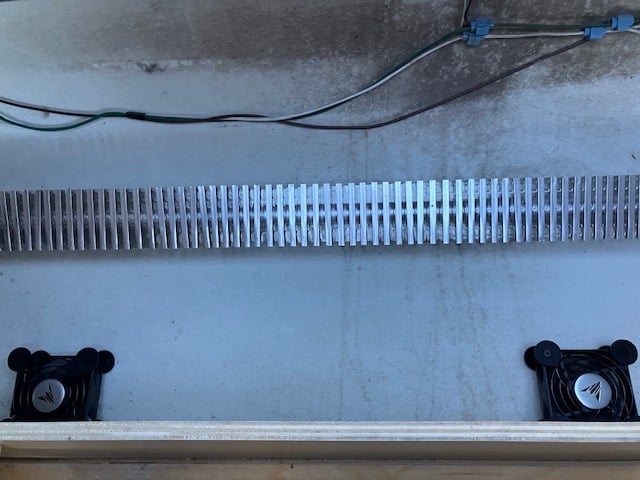

Finally, I added two switched 3.5” computer fans just below the convector at the back of the trailer, behind the bed. This convector is the longest, but often partially blocked by bedding, and I thought it could use a boost.

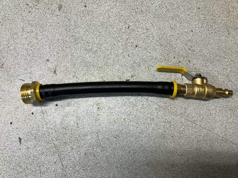

This is invaluable, for removing, flushing, and adding fluid. I used the copper tubes connected to clear plastic hose, described in the Guide, to flush out the fluid without disconnecting any hoses, by using forced air connected to the hose going to the expansion tank intake for the boiler and a bucket under the hose connected to the expansion tank return opening. I put a garden-hose female end on the in-hose, and connected it to a compressor with this:

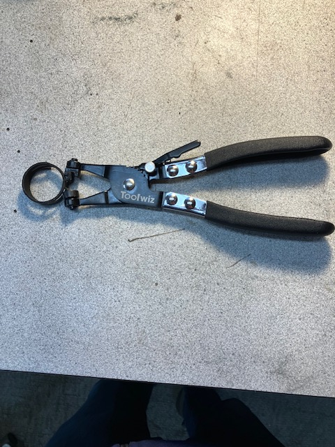

Spring Band Clamps (or Clips) First, a word about using worm-gear clamps instead. The problem with the latter is that the user may under or over-tighten them. When over-tightened, their sharp edges can cut into tubing. Also, road vibration may cause the clamps to loosen. Spring band clamps do not have these problems, and they apply more uniform pressure than worm-gear clamps, and the correct amount if they are OEM parts. The spring band clamps I saw on Amazon did not appear to be robust enough, according to specifications and comments. But the Alde clamps are great: high tensile, coated, thick metal (probably about 0.75mm) and just the right I.D. diameter and pressure design. Moreover, they have been redesigned since the ones I have from the 2017 installation. The rubber Alde hose O.D. is about 26.5 mm. The original clamps opened to an I.D of 27 mm, making them very difficult to slide over tubing expanded around heat-shrink treated convector ends. The new 29 mm clamps are redesigned to open to 29 mm but still clamp down to the same 26.5 mm I.D. Even so, I used dish soap on the outside of pipes on convector fittings to facilitate clamp installation. I double-clamped aluminum fittings, as suggested in many threads, including Corrosion of Alde Connectors, above. An invaluable tool for installing and removing spring band clamps are Hose Clamp Pliers:

While I had the convectors exposed I added these two 3.5” fans directly under the rear convector, wired them to a 12 V DC to 5 V DC USB converter, and from there to a switch. I spliced into the DC circuit for the Alde to do this.
