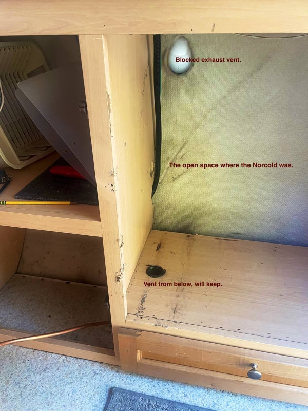

Yes it can be done. A month or so ago I removed the original finicky NorCold 3-way fridge from our 2005 DM T@B Romana.

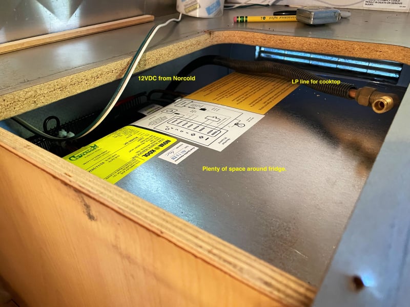

Recently we purchased a Nova Kool R2600, 2.4c u ft DC only fridge/freezer. I will post the specs.

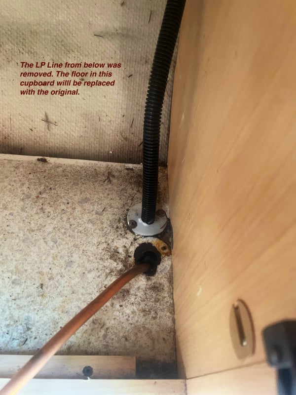

I started installation by removing the LP line that went to the NorCold and will cap the line from below with a FSAE Flare cap. I calculated the approximate position for the new unit and built a temporary platform to test the fit. A little tweaking will be done and a new drawer or cupboard will be made below the fridge and a new cupboard will be made to the side between the entry and the fridge. Both additions will increase storage in the galley.

Update. The Fridge is installed. LP that went to the Norcold is capped off and line removed. Prep for add'l storage is complete, just waiting for doors and small drawer to be made. Pictures:

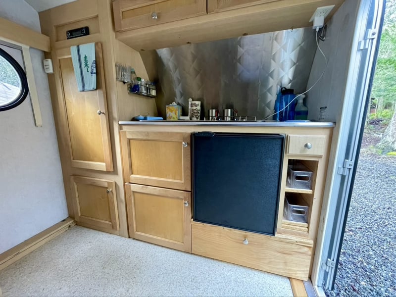

Finished...
