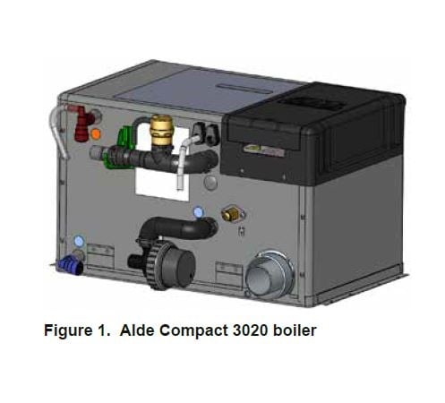

    @Wonderita welcome to the forum! From my reading you have the Alde 30320 system, similar to the one in our 400. There is an auto bleed valve at the boiler that can get sticky, and you might have the reservoir as your only high point for bleeding. If you can locate the circulation pump, you can operate it on CONT mode and turn the pump up to 5 to increase the flow thru the system. That may clear the air. Also raising and lowering the tongue have been used by some. You can search the posts for air and Alde and see what comes up
    Here is the 3020 diagram. The brass thingy is the air vent. Some folks have tapped on it while the unit is running to unstick it. Also the round black thing is the inline circulation pump  pump and it has a scale for speed on it.1-5.
