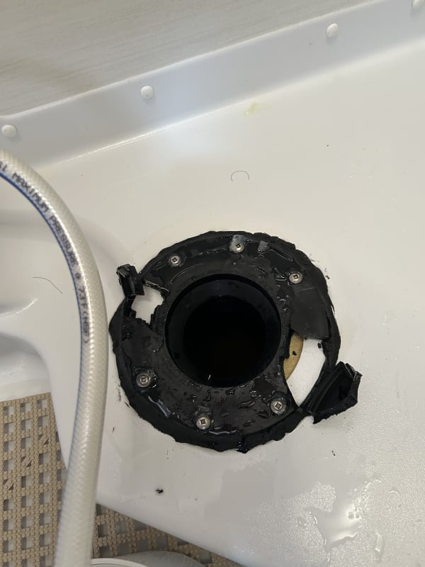

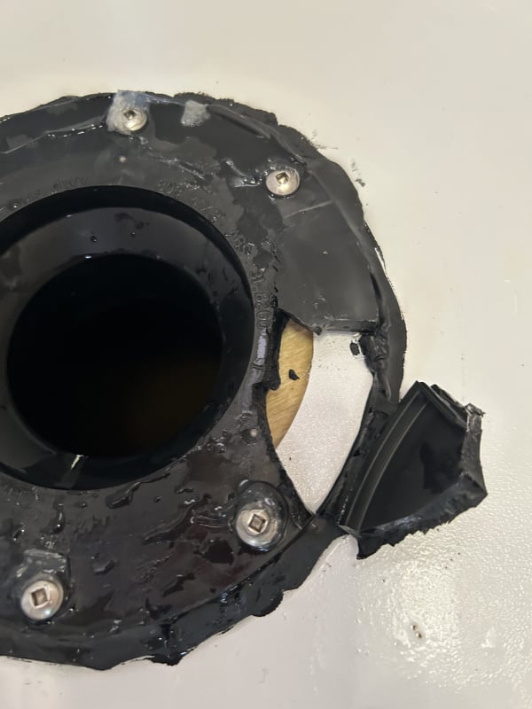

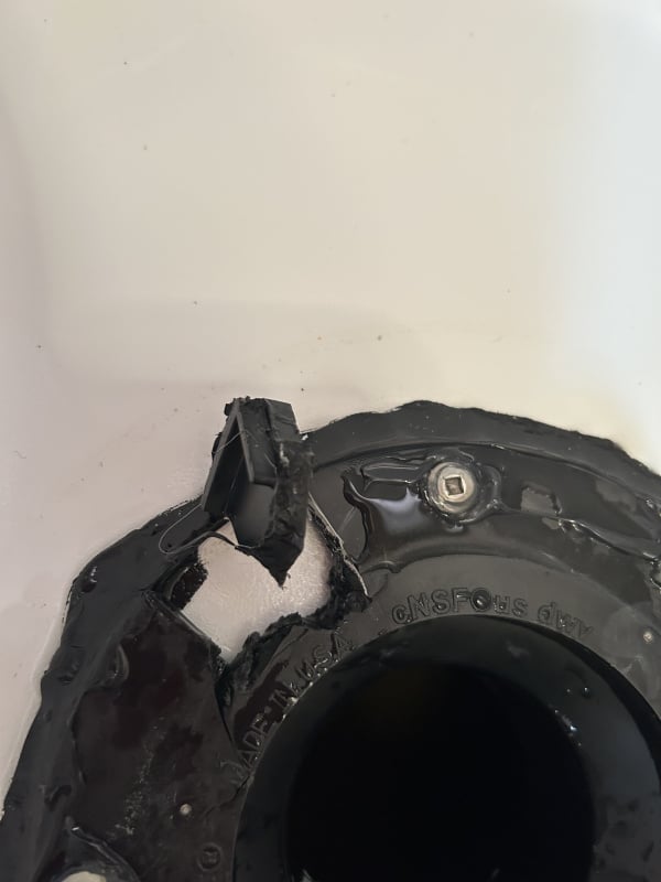

Have a 2025 400 boonbock . The toilet broke off yesterday while on a trip . The flange / seal broke , pulling the toilet bolts out of the flange .
On the road trying to locate a new seal. Contacted nucamp but have not got an answer back from them
I don’t think this is like a home toilet seal but would like to get this fixed asap on the road in Tenn.

Pictures attached .2025 400 Boondock Black Canyon0

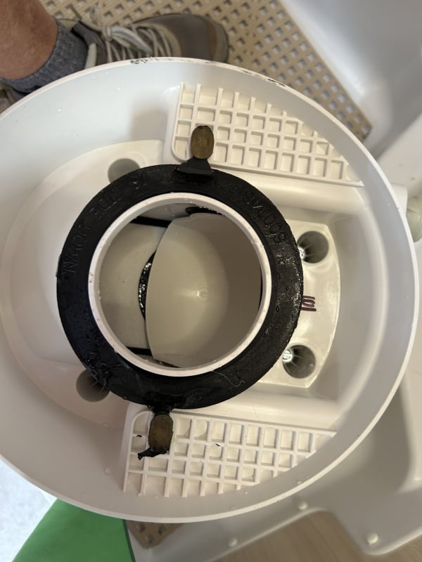

@MOS2 Found a thread with a Dometic toilet manual imbedded that might help you locate a replacement. Also has pictures similar to yours.
Good luck
https://tab-rv.vanillacommunity.com/discussion/18197/cracked-toilet-base
This should help ID the parts needed. Finding them could be a different story2025 400 Boondock Black Canyon0
It's likely a typical RV part, so look for an RV supply store. Possibly marine option also.Rich2019 T@b 400
In the thread linked by ghumberd above, there is a Dometic 301 toilet manual. The seal part is called a "Floor Flange Seal".
Thanks , but don’t need the seal. It’s the toilet flange that broke and needs replacing .2025 400 Boondock Black Canyon0
On the same Amazon page; It likely is this oneMOS2 said:Thanks , but don’t need the seal. It’s the toilet flange that broke and needs replacing .
https://www.amazon.com/385311652-Replacement-385311658-Compatible-Dometic/dp/B0D73LR9CC/ref=pd_lpo_d_sccl_1/140-6211229-7074840?th=1
