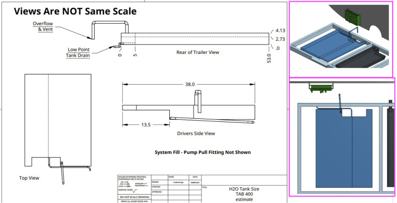

Based on Factory Tour pictures and owner posted pictures I agree with your general Fresh Water Tank description. Over the past winter I was very interested in switching to a 400 from my 320S and did several investigations of the 'behind the pretty walls' stuff.benpc said:
. . . pictures of the tank on the forums and it’s fairly short, narrow, and shallow, stretching
from one wheel to the other. 52” L × 24” W × 5.5” D or so I guess.
Here's my take on the Fresh Water Tank:
