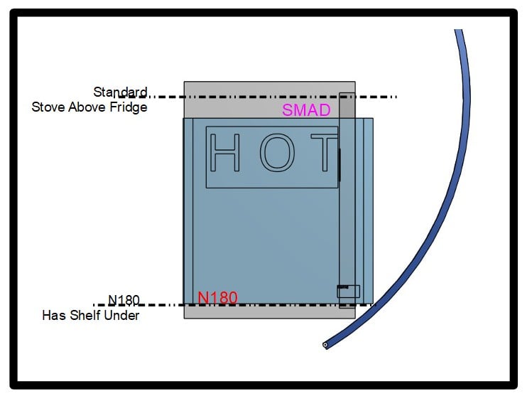

Disclaimer: No direct experience replacing the N180.
Have you researched the 3-Way Fridge Models installed in current production Casita and Scamp trailers . . . as I don't believe the SMAD will fit in a 320S.
nüCamp placed the small drawer under the Fridge to raise the N180 to allow more space due to the curved TAB front. The SMAD appears to be taller than the N180 . . . however, removing the shelf does not provide enough space for the SMAD as you have the curved front issue. Also expect any 3-way with the cooling HW in the rear [N180 has it on the right side] will require additional air circulation fans or vents to provide best operation.
Simple reference diagram:
