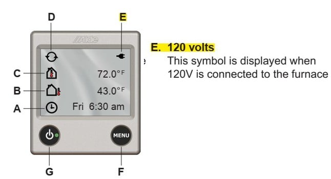

The Adle Control Panel will display a power plug symbol if the 120VAC is available.
If no "E" symbol is present:
..1.. Is the Adle power cord plugged into the Alde compartment 120V outlet?
..2.. Are the 120VAC circuit breaks at your AC Distribution panel turned on?
If Yes to '1' and '2' but still no "E" symbol . . .
..3.. Is the Alde compartment outlet working, will a light or fan,etc work when plugged into that outlet?
