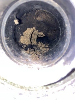

Turned the heat on full throttle. Maybe 5-10 minutes, I came back to see smoke coming out of the Alde outlet along with some moisture dripping (attached a picture of each). It didn't smell like a fire and no smell inside. The heat was on inside. The outlet is blackened, but not really hot or melting. Shut it down to see if I can get some advice.

Soot would indicate either more fuel or less air than what the boiler was designed for. Could be the gas pressure is too high (unlikely) or the air intake is clogged. Remove the cover on the outside, there are two concentric tubes behind it. The inner is the exhaust and the outer is fresh air for the burner. See if any insect has set up shop there. Worst case remove the whole tubing on the inside of the trailer.

I am going to take off the outlet tomorrow to see if there is anything obstructing the flow. If I don't get lucky fiddling, I will call Alde on Monday to hear what they have to say.

I figured out my problem. I bee nest… Cleaned it out and it works great!!!
