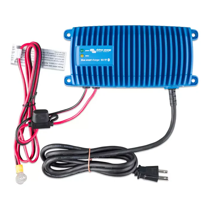

    We didn't touch the WFCO. We just added this Victron charger in parallel to the WFCO and solar chargers. It's been working great.
    https://bluemarine.com/products/victron-blue-smart-ip67-charger-waterproof
