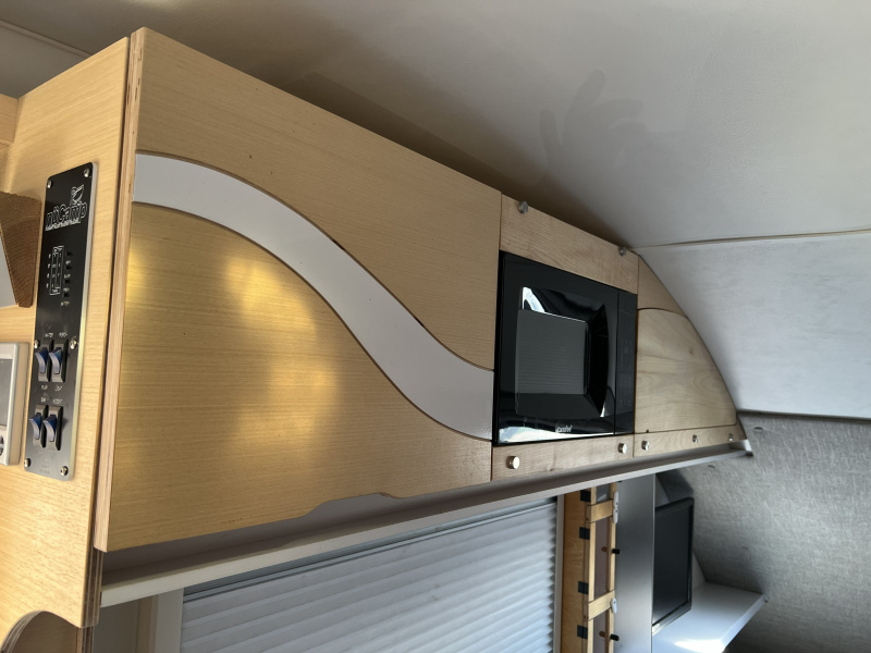

There seems to be mixed feelings on adding a microwave and to be honest I was reluctant since you loose valuable cabinet space but there are times that it is a nice thing to have. Since I split my time between boon docking and powered camp sites I thought the only way it made sense is if I could easily switch between microwave and cabinet. I think I found a good solution and in the process made much better use of that swoosh pocket which I always hated and though was more about looks than function.

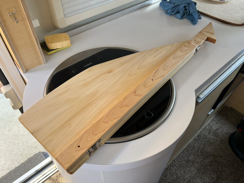

I really missed the real maple wood from my tab 320S so went back to that instead of the plywood. It's certainly not a perfect match but that's ok with me as I lean a bit more on function over aesthetics.

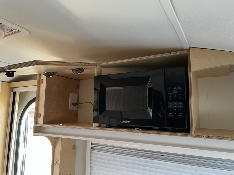

My solution was to add a plug inside the cabinet and found a microwave with a perfect fit. https://a.co/d/0gkqw92f

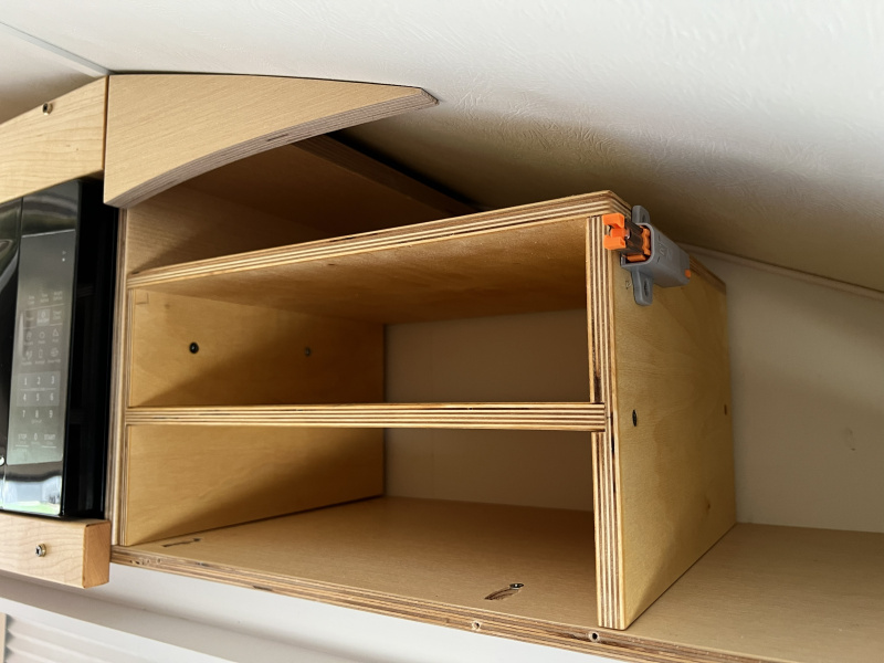

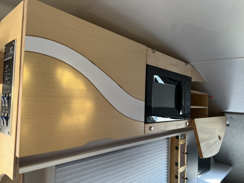

added screws from the front for the wood that contains the microwave and finishes the top and bottom area with some capped screws to make it look more finished . The screws they provided were too small so I use my own. Pocket screws are not a good solution to repeated removal in my opinion and it's not practical in this situation. I added a shelf feature with a push type latch for holding the door Amazon Item
Here's a detail showing the hinges
Overall I think this was a good solution for me and very easy to go back to original configuration or just to replace microwave with cabinet. It was a bit tricky to match the curve of the ceiling and you'll probably notice a few oops's but hey, that gives it personality. One of the drawbacks is that you end up with a few extra holes in the visible portion of the plywood when you add the cabinet door back but that's ok with me.
