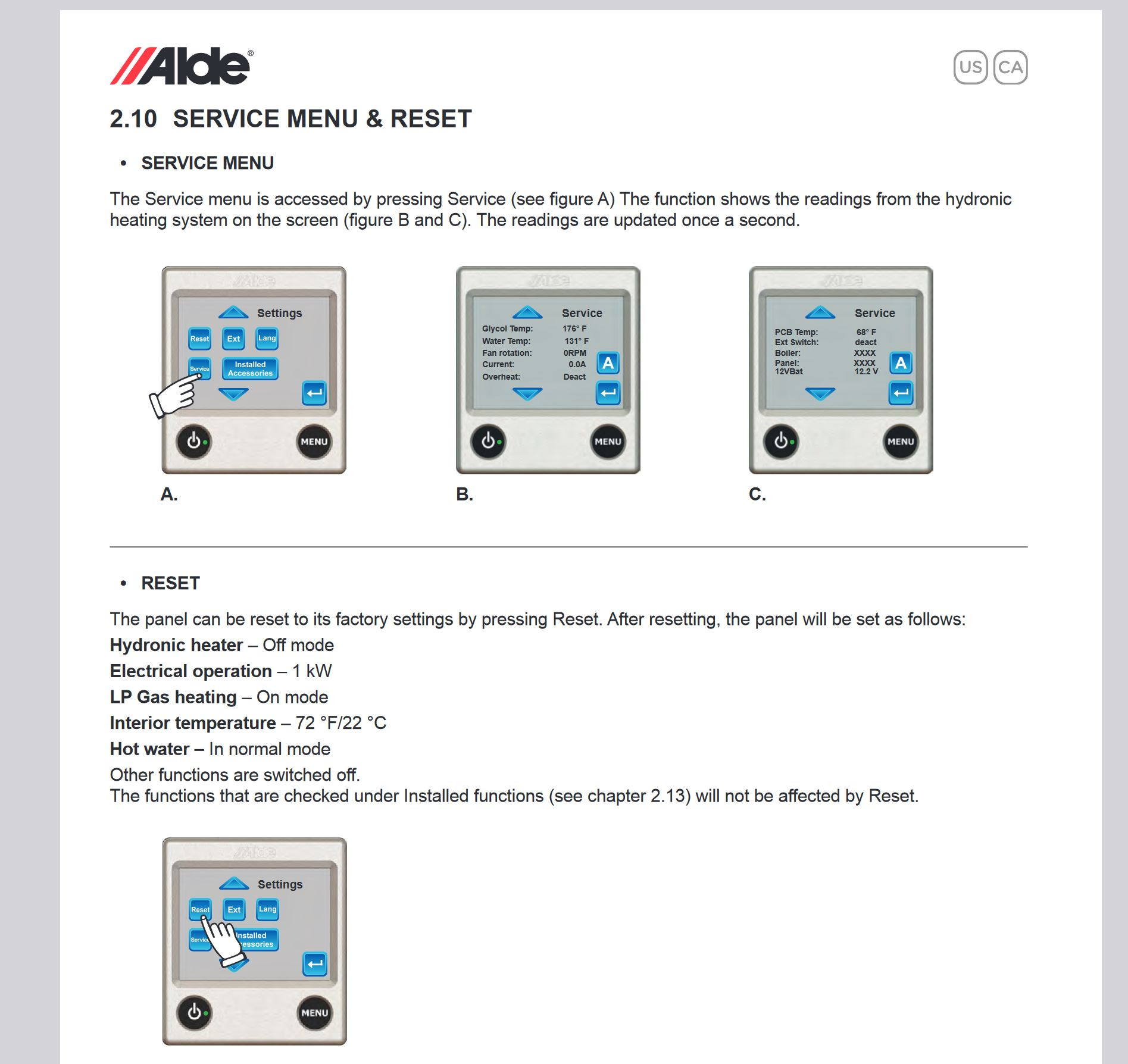

When you are running on propane, can you actually hear the Alde working? Is the exhaust fan running? Have you checked the "Service Menu" on your Alde to see if the Glycol and the Hot Water tank are actually heating? In theory, if you are getting hot water on shore power, you should be getting hot water on gas, but that would be assuming the gas is actually heating the unit. This is what the Service Menu looks like in a 3020. You can find this in the "Tools" menu. You can find the Glycol and Water temps there.
