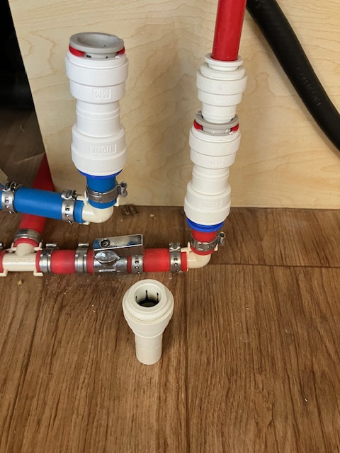

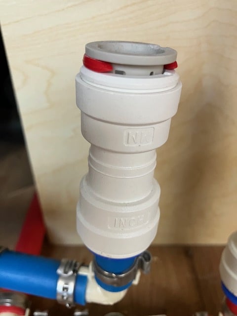

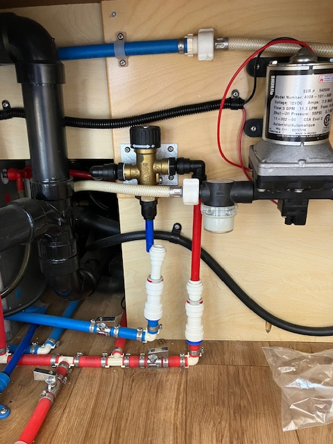

    1st photot shoes ring in a locking collar on another fitting. 2nd photo shows the fitting the the lock is missing on and I suspect that fitting was forced off , releasing the water that caused the water damage. 3rd photo shows the are inside the clam shell, under the counter where the fitting fell apart when I was checking fittings to see if I could find a source. I'm can fix this but I need a source to go to for the fitting and some extra lock rings….HELP plaease

  • Pintoplumber
    Pintoplumber Member Posts: 182
    Push the fittings back together again. Where the missing red ring is, put a piece of solid copper wire in there and give it a twist like a bread twisty.

  • antiquemoto
    antiquemoto Member Posts: 7
    That had been my backup plan. There is a couple of rough spots on the blue male side and I thought I'd lightly clean that up with some emory cloth to ensure a good , clean grip by the bite grippers in the union?
  • Pintoplumber
    If you do that, make sure you don’t disturb the surface where the oring seals. Personally, I wouldn’t do any sanding.
