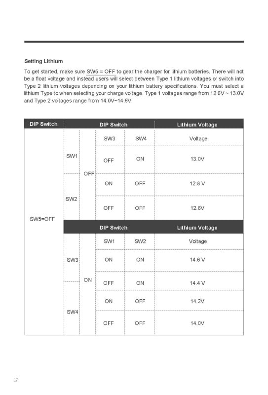

I have a Renogy DCC1212-20 DC-DC Charger.

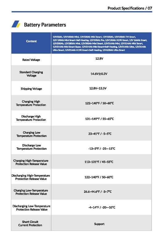

I just installed a WattCycle 12V100Ah Mini into my camper.
I need to change the settings on my DC-DC Charger for the Lithium.
The dipswitch instructions and the battery parameters for each of the units is below.
What would be my recommended dipswitch settings?

That's a weird table. Not done by an engineer… :)
Switch 5 off and switches 1-4 on sets it to 14.6V which is right on target for the battery.
