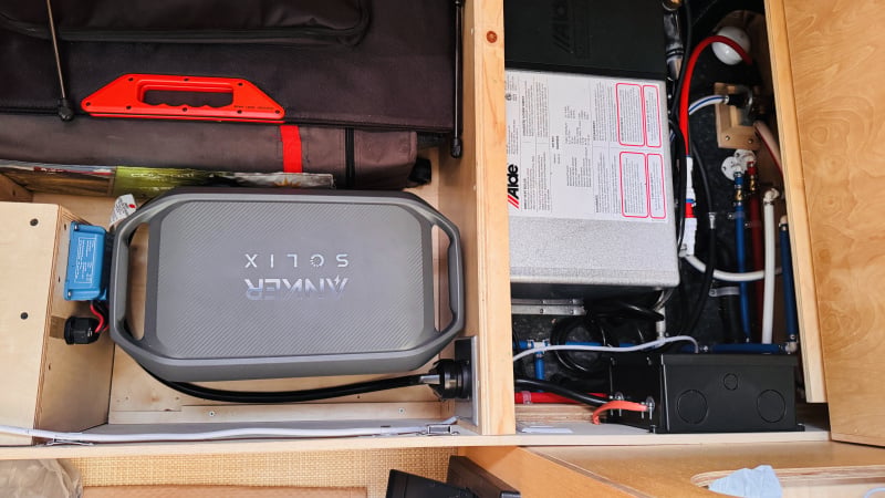

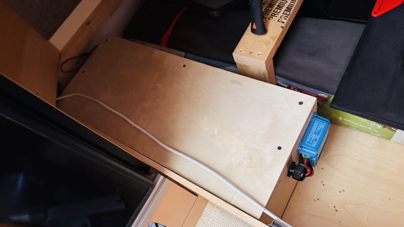

I wanted to use this as my inverter and extra battery power when needed for my tab400. My 2019 has a large storage area under the bed and the power station can fit under the bed no problem. I modded the camper to use this power station as a shore power alternative when boon docking.

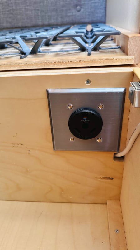

I installed a female 30 amp shore power outlet under my bed.

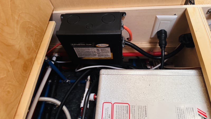

Then installed an automatic transfer switch under the bed where the plumbing is. The transfer switch will automatically switch to either the outside shore power plug or the inside outlet that I installed depending on which one is supplying power to it.

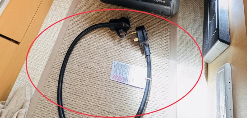

I made a cable with 2 male 30 amp plugs on both sides
So now I can put my power station under the bed, plug it into the outlet and when I turn it on, the transfer switch does its thing and then I am powering my camper with the power station.

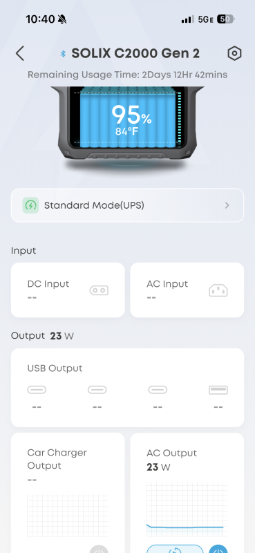

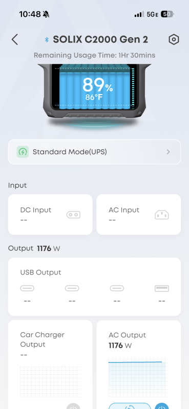

It powers everything even the AC! With the AC running and nothing else, it pulls around 1100 watts. When it is Idling it is only 23 watts!
And there is still plenty of power to spare. I can run the camper just on the power station or I can turn on the camper battery and it will charge it. Now the AC will eat up the power very quickly. So it really would be used for that. But if I need to cool the camper for a few minutes it’s nice to know I can.

Nice - the costs of these have dropped a lot. I have one suggestion for others doing this:
Avoid the use of a cord with pronged plugs at both ends (aka a suicide cord) by installing a male flange-mount receptacle for the under-the-bed connection, e.g. something like:
https://www.digikey.com/en/products/detail/ac-connectors/ASINL530P-FC/21344063
This is similar to the standard shore power port outside. You'd use a more normal 30A RV extension cord (plug at one end, socket at the other) to connect the power station to the T@b.
Suicide cords are much more prone to accidental contact with live high voltage prongs. Both ends of the cord stick out, and either end can be live. With a standard RV cord, if you plug in the pronged end in first, you're much less likely to zap yourself.
