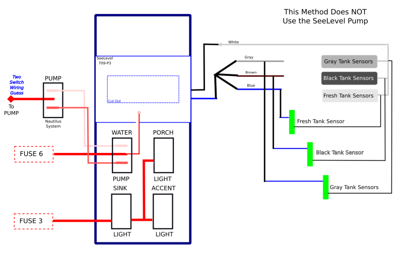

When I was considering switching to a TAB 400 I did a little preliminary research.
- SeeLevel Sensors glue/tape to outside of tank so underside airflow cover must be removed.
- SeeLevel can use the installed wire from tank to monitor panel.
- SeeLevel has a different display panel that has to be mounted.
- I was planning to cut a hold in the nüCamp panel in area of the LED monitor.
So doable but not a basic modification.
