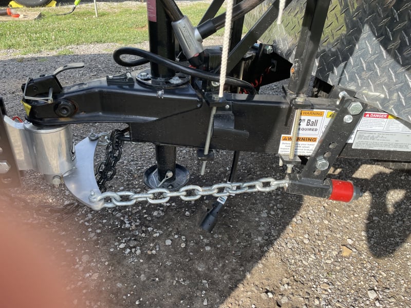

I’m picking up a 2026 nuCamp TAB 400 Boondock Black Canyon and I’m trying to figure out the best weight distribution hitch solution.
Because of the new front storage tub and the shorter tongue, it doesn’t allow for the standard setup to fit properly. I’ve looked everywhere online, spoken to a few dealers, and honestly no one seems to have a clear answer—especially here in Canada.
Has anyone successfully installed a weight distribution hitch on a 2026 TAB 400 Black Canyon? If so:
● Which hitch did you end up using?
● Did you need any special brackets or modifications?
● How has it performed while towing?
● Most importantly, does anyone have pictures of their setup?
Any advice or photos would be greatly appreciated. It seems like there aren’t many real-world examples out there yet, and I’d love to see what others have done before making a decision.
Thanks in advance!
Guy

Understood. There are a few manufacturers (e.g. Curt, Reese, Blue Ox) that have bolt-on hangers as opposed to the common clamp on style. Maybe that works.
Hi,
Have you looked at the Anderson WDH. It needs a minimum of about 25” from the center of ball to bracket mount.
This WDH is very easy and quick to put on. It also includes a friction cone to help with sway.
Their customer service is usually quick and helpful if you have questions.
We use the Anderson on our setup up and like it a lot for performance and ease of use.
