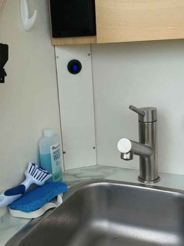

I placed the switch in the left corner of the galley -

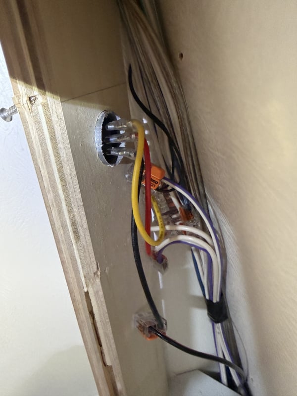

The wood is piece is too thick to use the retaining nut that came with the switch so I have a press fit. On our trailer the purple and white wire supplies power to the plunger switch. The punger switch wires are thin and black. Not the greatest photo but this is what my wiring looks like -
The power/batttery wire needs to go to the middle terminal (red wire). The plunger switch wire goes to the top terminal (yellow). I ran a dedicated wire to the ground bar under the driver side bench. It was easy to run the write down the chase and through the conduit that runs back under the bench. I probably could have picked up a ground in the chase somewhere, but did not want to mess with existing wiring.
