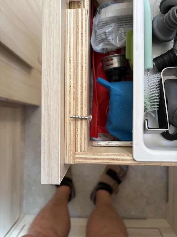

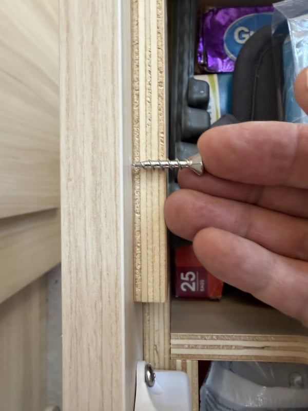

While preparing the TAB for an outing I noticed the drawer face was not attached to the drawer on the right side of the drawer. The reason was the screws on that side were not long enough to penetrate the drawer front. Further investigation revealed the drawer construction on that side had an additional piece of wood for the divider. nuCamp used the same length screw. The left side was fine however the right side did not catch due to the extra piece of wood. Removed original screws and replaced with longer screws problem fixed. Photos attached. Poor quality control at the factory.
