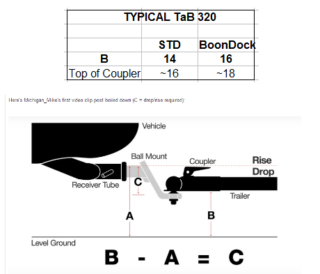

Hello. I am new to Rv'ing. I just got a 4Runner with hopes of getting a 320 very soon, maybe from a private sale. I have a class 3 hitch. Can anyone provide a recomendation on the ball mount? I think I may need a drop on it, maybe 1-2 inches??? I just want to be prepared if I go see one, that I can properly haul it home.

    Tow Ball drop or rise will depend on the model of the 320 as well as the 4Runner heights.
    Older years had a standard and Boondock trailer height.
