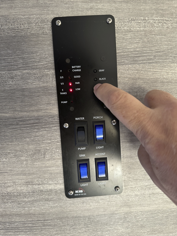

Hello all— Help please—2018 Tab 400-- the little toggle on off switch for the water pump just broke - cannot pump any water -- the switch just flip flops up & down. Can the entire KIB panel be replaced? Or just this switch? Is it even possible to get a new panel or switches for this trailer? Thank you

    I'm not sure what exactly your KIB monitor looks like.A quick search online showed all sorts of different arrangements.
    But, it should be easy to unscrew from the wall and take a look. There are KIB monitor switches out there, and probably some generic ones that will work.
    KIB Pump Switch Amazon
    There are other examples there on the Amazon page. If it is as simple as removing the old switch and reattaching the connectors, it should work.

    @lkc001 This is what the KIB monitor looks like (different years have different looks).
    See Level panel looks like this. There is a ton of wiring info for the See Level panel, but I bet either pump switch will be easy to install.

    The old Travels with Delaney YouTube videos showed most all the systems on his T@B 400, which was a 2018 model. Looks like the KIB monitor panel that @pthomas745 shows.
