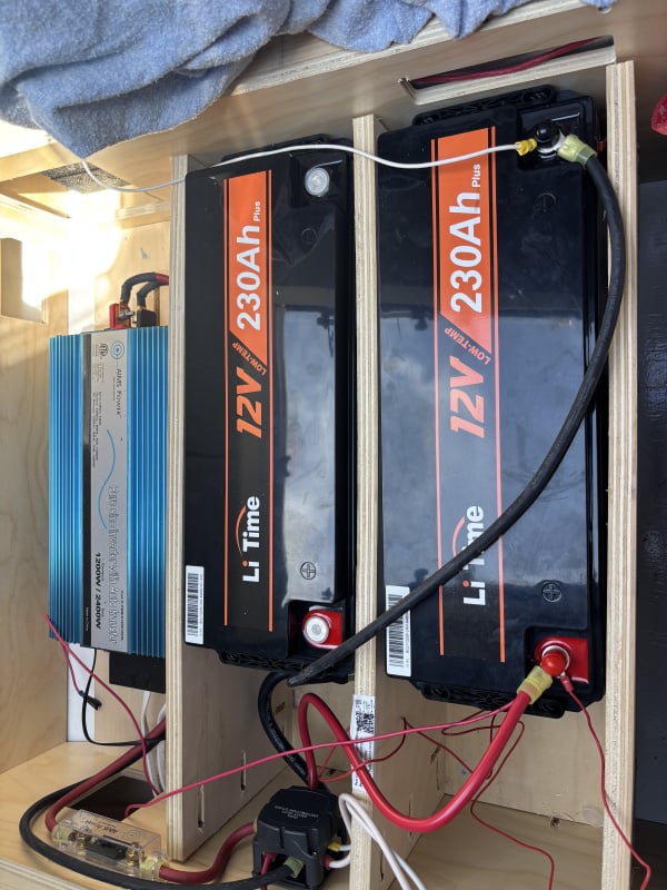

wound up going with two Litime 230ah batteries in parallel with 150 amp marine fuses on each battery for safety in the event of a short circuit in one of the batteries. They fit perfectly into the spaces. Left the 2400/1200W inverter in place as well as all the rest of the electronics.

a LifePO4 battery can dump 10x its amp hr rating (in amps) into a short circuit. That’s 2300 amps for my batteries. If one of the batteries in a parallel set up develops an internal short, the other batteries can discharge into it at that level. Hence the fuses, which cost a few bucks. An added benefit is there is more room to hook up to the positive terminal with them in place (the Litiime battery pays are comically short)
Can you post some photos of the batteries and how well they fit in the box?
Thanks
will do as soon as the fuses get here

Here is the pic showing that two Litime 230ah will fit in a tab400. I’ve disconnected the one to get ready to return it.
