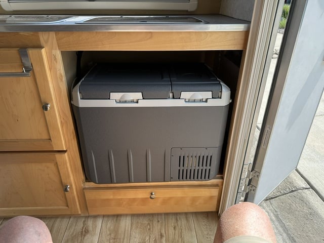

I ended up with a 37 qt dual zone by EKOJUCE that I found on Amazon. I was
hesitant at first as I had never heard of the brand but the form
factor and dimensions were almost identical to a Bodega product that
had great reviews....but was out of stock. After some serious testing
at home, I'm a bit more comfortable. It cools down fairly quickly,
and in eco mode fluctuates in temperature only about 3 degrees while
consuming about 31 watts.

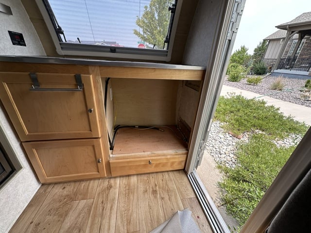

With his insight, I was able to remove the fridge in about an hour
with no major mishaps! I did have a professional cap off the propane
line after I removed the fridge.

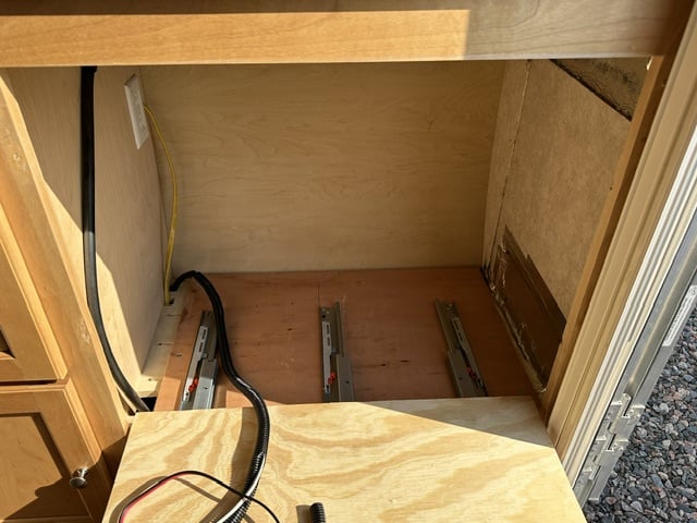

When I removed the fridge it was apparent that it had been removed before
(I'm the 3rd owner). The screen door upper corner screws
had been taken out and the holes had been enlarged showing multiple
uses. The wood shelf under the fridge on the passenger side showed
some water damage either from the fridge itself or from water
entering the lower vent on the exterior wall. Most surprisingly, all
of the pocket screws which attached the shelf to the exterior wall of
the trailer were missing. After fridge removal, I replaced the pocket
screws, braced the bottom side with a short piece of 1” board, and
overlaid the entire area with a piece of 1/4” plywood.

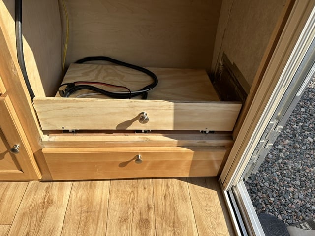

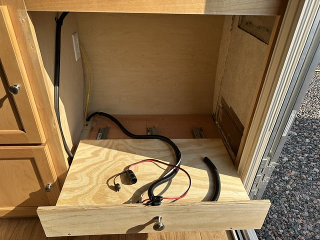

I used a piece of 3/4” plywood for the base of a pull out shelf mounted on
three 17” undermount shelf slides. For power I reversed the
existing 120 volt fixture so it faced the new opening and spliced in
a 12 volt cigarette lighter style female plug to the existing 12 volt
line.
