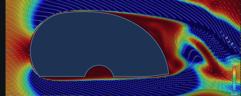

    I am working on a project to model the trailer, and play with aerodynamics - and am not very far along - but I do have a basic one set up that kind of shows where I think the problem is.
    CAVEATS: this is super basic and simplistic - not a legit scientific case. Fluid dynamics is complex, the model is very incomplete, I don't have the TV modeled in front of it, etc. Also - this is using a very basic wind tunnel simulator.
    However - many people way smarter than me have done lots of work and research on this stuff. There is plenty to read up on.
    The gist is that the back of the trailer develops a high pressure spot that rips the boundary layer off the trailer violently - and we don't want that. That causes not only a lot of drag, but really unstable wind.
    Vortex generators or a spoiler of sorts at the breaking edge on the top rear there would help a lot - just that there are big windows and solar panels there so I am not sure what we could do.
    I am noodling on it.

    Awesome modeling! I'm surprised there isn't negative relative pressure on the back. As shown, there's more positive pressure area in the back than the front, so the air is pushing the trailer forward… It would be interesting to put a tow vehicle in front to disrupt the flow on the trailer, like real world conditions.
    Yeah, I am working on getting everything into a 3D model, I got the front box on the model now. I am learning how to use the CAD tool while I do it. Next step is the wheels. I have two goals, to get a pretty accurate model - and to make one which would be really cool to 3D print. I also found an exact 3D model of our truck that I can buy - but until I get that, I have an approximation I am using (their high detail though is making it tough - an awful lot of triangles in there).
    What this single 2D snapshot doesn't show is the flow changing. That pressure area in the rear keeps collapsing and re-building, over and over. It is likely that instability which is "pushing" the back of the trailer around back and forth creating the wiggle.
    In addition to stability - smoothing that out would reduce the drag and increase fuel efficiency when towing.
    I kind of wish the trailer manufacturers would pay more attention to this. It is not expensive to mitigate if done in the design at the factory.
