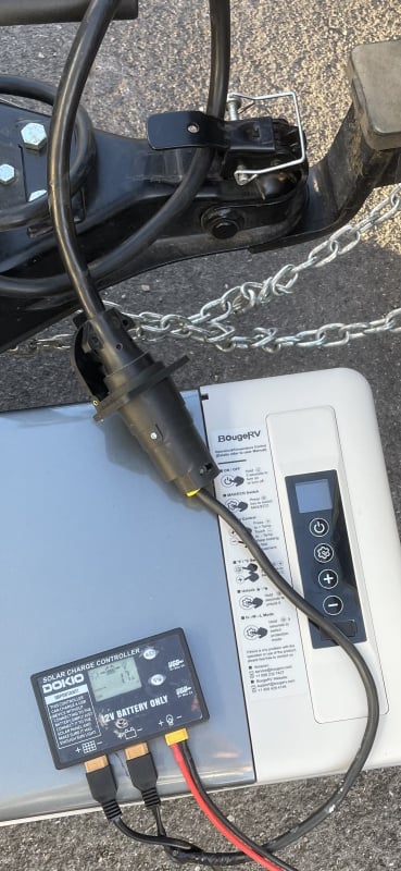

Anybody hooking up their solar through the 7 pin plug? My solar controller is not detecting the battery for some reason, any thoughts? The battery switch is on position. Solar panels connected directly to the battery works. Could the battery shunt be the problem?

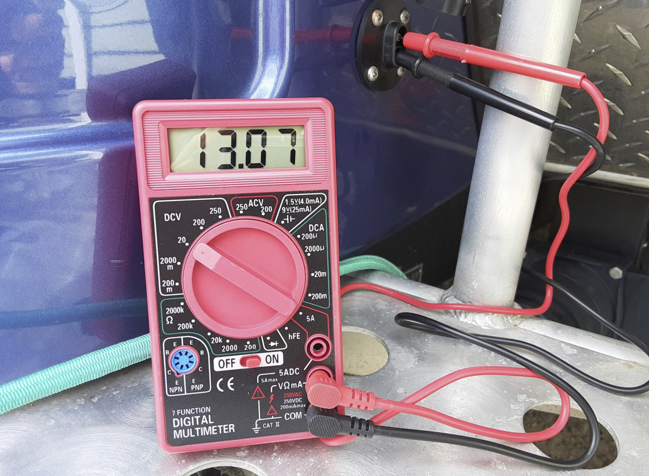

What you need to check these sorts of things is a simple multimeter. And, yes, it is possible to charge the trailer battery through the 7 pin plug. Before you start plugging things in that way, the meter will tell you if you have the 7 pin wired properly from the solar controller. You can just start trying it out, but have a handful of 30 amp fuses available if you go that route. There are several Forum threads that discuss using the 7 pin plug for attaching an extra battery, things like that. It can be a good way to do what you want to do.
Assuming you are trying to connect to the "SAE" port on the trailer? Or some different connector?
The meter will show you how the "port", of any type, is wired to the battery: which "side" of the port is positive or negative. Once you establish that, wiring the controller to the port is straight forward. The meter will also tell you if the port is even wired at all.
This is a multimeter (inexpensive at Harbor Freight, etc) that will show you what you need. In the Tabs, You can see the "positive" wire from the battery to the port is on the "top" of this connector, the negative on the bottom. If you look at the SAE cable, the part of the cable "inside the plastic" is supposed to carry the positive output from the solar controller. The "big metal part" is the negative output. Doesn't matter if that "red cable" is on the "negative" output from the controller that has that metal part on it. The meter is the final authority!

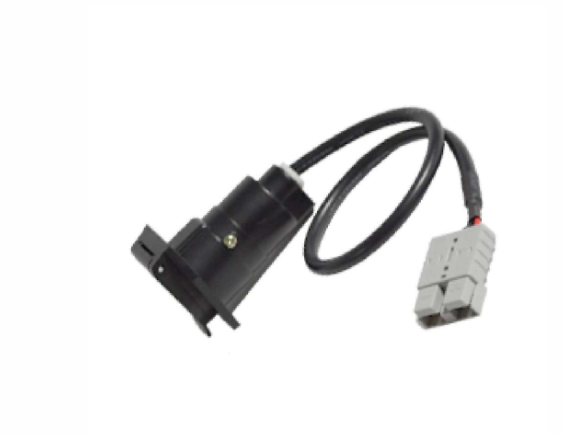

And, of course, there are the "adapters". We can show you how those can be used, also.
You would need to check your 7 pin adapter in your photo also. Not sure if you built that one yourself, or have found it "premade". A quick check with the meter will help you see if the wiring is correct.
So, find a meter. Figure out the SAE port, or whatever port you happen to have on your trailer. Wire it properly. Trace the positive and negative output from the solar panels, into the solar controller, and do the same thing for the cables out from the controller.
Take some more photos, we can help with all this.
Thank you for taking the time to respond will use a multimeter to check for proper wiring the 7 pin connecter that was purchase online.

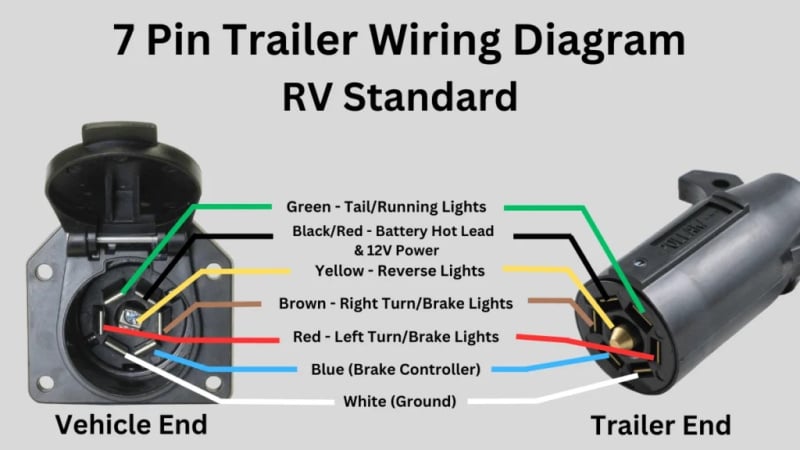

Don't know if you need this to help with troubleshooting @RayJim, but posted it just in case. Black and white should be path to the trailer battery.
