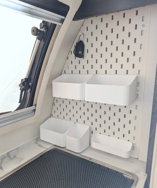

There have been previous member posts of installing this IKEA pegboard. Attemping to keep our counter top free of the inevitable clutter.
Bought 22"x22" SKADIS pegboard. Made paper template, cut with jigsaw. Screwed wood strip along bottom and right sides plus small length by window. Used silicone to attach to counter and wire duct that ran along right side by door.
3D printed bins and key hook in PTEG filament for heat resistance from Printables.com Link has various bin and tray sizes. Total cost of pegboard and filament ~$30 here in Canada.
Link to Printables site
We will see how this works for us. May print small bins to right of key hook if needed.

    @brianb that's a great idea to maximize using that space. Thanks for the inspiration.
