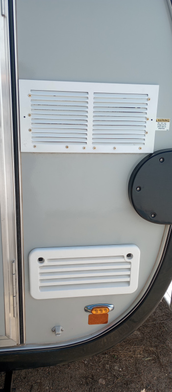

2019 T@B 320 S. I lost an exterior vent cover while traveling. I tried finding replacements. NuCamp had one for $108+ ... Someone offered a 3D printed replacement for $80+ ... I ended up by getting a standard furnace duct cover, 14" x 6" duct size, 15 3/4" x 7 13/16" external dimensions for $7.50,
tapping holes in appropriate places and screwing it on. Not kosher, I know, but looks decent and functional. I just couldn't afford the alternatives. Will do the same if I lose the lower cover.
Hope this helps.
