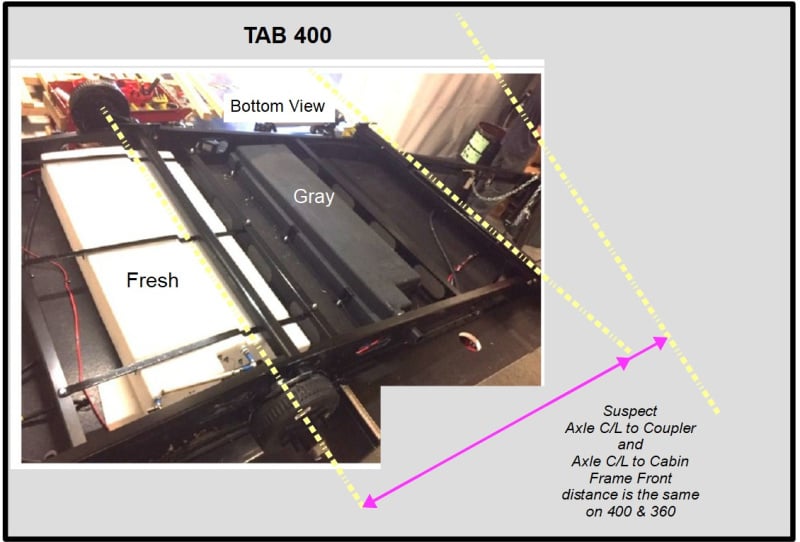

Has anyone dropped the belly pan (wind & road debris guard/cover) and
documented the underside . . what's under the floor . . on a TAB 360 ?
The limited Factory Tour pictures of a 360 Build don't cover those basics.
Based on general model dimensions I suspect the 400 & 360 are nearly the same between the Coupler and Axle center line with the exception of the 360 being 4-inches narrower. The LOA difference appears to be in the space rear of the axle.
So one would guess the 360 tanks are nearly the same as a 400:
  • Fresh near axle and Nautilus
  • Gray forward, near shower and sink drains
Would be nice to confirm . . .
