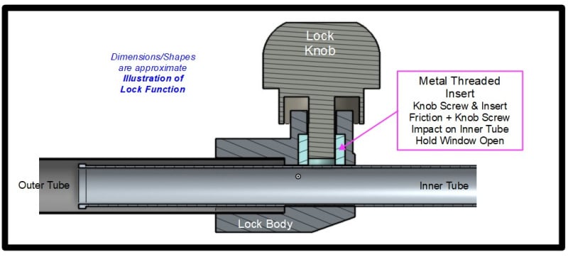

As @MOS2 noted the window strut arms are a very simple design.
The Knob Screw impacts the arm tube (like a set screw) to hold the window at a set angle. There are no real 'user repair' options, while there maybe are several hacks to try.
For the original issue of Not Holding the Window Open:
- Remove the Knob, inspect inside of knob to ensure nothing is blocking it from fully seating.
- Inspect the metal insert in the Lock Body for blockage.
- Inspect the inner tube for the Knob Screw 'bite marks' is it engaging.
- Consider ways to make the Knob Screw hold/pressure on the inner tube tighter:
- would plumbers tape on screw help
- would placing a small bearing (BB ?) help; small contact surface = more pressure, and if knob is not screwing down enough could provide more clearance {at cost of fewer insert threads engaging}
- Some other way to increase the knob screw force on the inner tube. Sharpen the screw tip?

I have inspected the knob and understand the design . I have yet to clean the inner tube . The little black points on the knob seems to be ok🤷♂️
That rear window is large and wonder if it is too heavy for the friction strut to hold the window open
